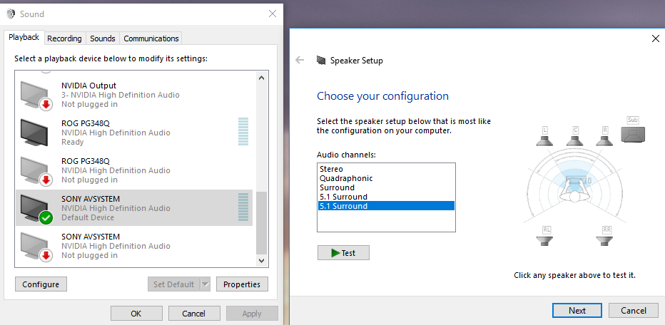

Optical or HDMI. I use the latter as I can properly set everything up and get 5.1 showing in windows. Does come with its own caveats using HDMI though in that the av receiver will be treated as a phantom monitor.

Yup a single cable from the HDMI on the GPU into the HDMI in on the AV receiver and voila. As mentioned, it does come with a slight caveat in that the AV receiver will appear as a phantom monitor (so a second monitor in your system). Set your monitor setup as extend desktop and select the AV receiver as the audio out and job done. just ensure once setup you go into the speaker config and set it up as 5.1 as by default it will be stereo normally.

Got it all set up it works great, i see what you mean about the phantom monitor bit, i just set it as small as possible no big deal , i have the arc out going to an input to my tv so i can just switch to that input to change settings etc. :) the surround sound experience with a set up like this is so much better than some of the all in one systems i have owned (Creative inspire 6.1, Logitech Z680)
Nice, yeah can be a bit odd with phantom monitor and sounds like you have done what I done and just set said phantom monitor to a small resolution. Found it makes neglible impact on performance so all good in that regards also.
