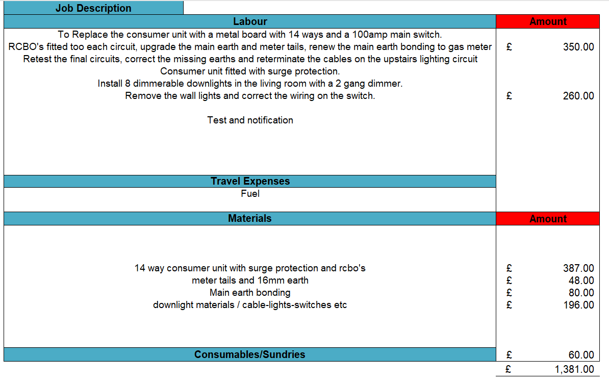

Finished today... total cost for new cu and new lighting in the lounge + pre inspection & fix was less than 2k. 3 days total.
New cu.. all metal, overcurrent protection and all that good stuff.
The lounge had 4 wall lights we ripped those down and replaced them with 8 dimable led downlights.. new switch etc... total cost of everything all in was £1681
This might be useful for the op but we just paid a day rate based on what was going on... all agreed beforehand:
I already paid a £300 invoice for the day of inspection and fixing things.
