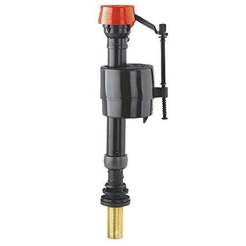

Replace the whole thing with this : https://www.amazon.co.uk/gp/product/B004O8601M/ref=ppx_yo_dt_b_asin_title_o09_s00?ie=UTF8&psc=1
we have the same (design) the water comes out the base so low noise too.

Would that Fluidmaster be a direct replacement do you know or would I need additonal hardware to connect to the inlet pipe? I'm pretty sure the inlet pipe on mine goes direct to the cistern (i.e. no fitting outside of the cisterm that the brass pipe would connect to) so I'm thinking that the brass thread part would sit proud (underneath) the cistern? Can someone confirm? I don't want to be spending extra to not having it fit.

Take photo of bottom of cistern where it comes out but from your internal photo it looks the same with a white plastic threaded part underneath (my old one was plastic but can leak over time so brass is better).
All the valves I've seen have had standard fittings.
If you remove the existing fill valve you'll be able to compare it to what you've bought before you remove it from its packaging.
If you want to be sure, remove it and take it to a plumber's merchant and ask them for a direct replacement.
