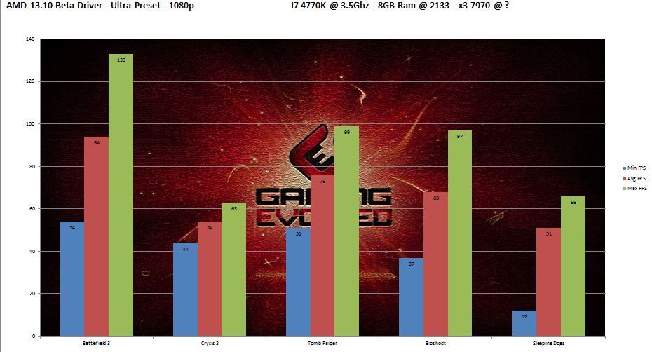

Not sure what to make of the results tbh. I didn't tinker with any settings prior to benchmarking, just stuck the games in eyeinfinity and did it.
Crysis I had to completely disable AA otherwise it was just running at 0FPS, lol.
Sleeping Dogs although in EyeInfinity mode didn't seem to have anything showing on all three screens so not sure it benchmarked correctly anyway.
I have nothing to compare these too so none the wiser at the mo :)
Maybe it would be better getting some 3DMark software and test that way.
Whats that? A graph for ants?! :p
Nothing wrong with it...
:D
Good work nonetheless Andy, although, I think I need to get me a pair of those shades...
Something's not totally right there Andy. I get considerably better results with my 7950 crossfire set-up over clocked.
I would suggest using msi afterburner and adding the overlay to monitor all gpu's. You want to see gpu usage, core clocks, mem clocks, voltage etc etc. That way you can make sure all is working as intended.
I notice you also left your cpu at stock. Not ideal you want to be over clocking that to remove any potential bottlenecks. Nonetheless that should not be the reason for worse results.
Did you disable ULPS? Are all gpu's seeing good and consistent usage? Have you tinkered with your page file?
