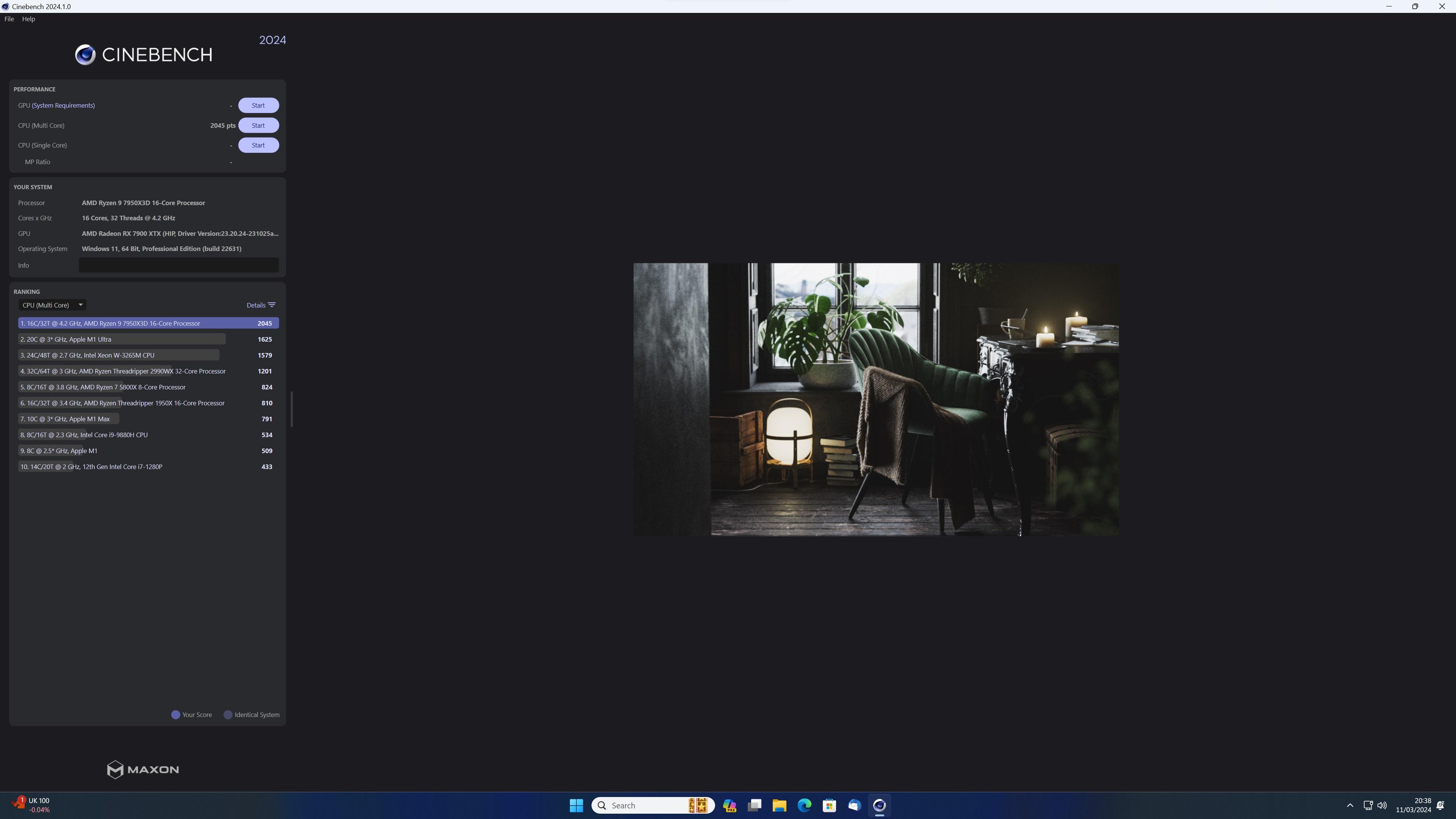

Well I ran Geekbench V6 and I got a multicore score of around 13000, checked google and most were getting over 19000 with my CPU so I knew something was wrong.
Did a fresh install of Windows 11 off a USB stick and that got past 84% and installed fine, guess my DVD drive was at fault. Ran Geekbench V6 and got a multicore score of 20055...
Also tried Cinebench 2024 and got a score of 2045, better than the 2003 I got with my old install.
Tried 3D Mark and that was about the same. So much as I didn't want to reinstall looks like it was the right thing to do.
