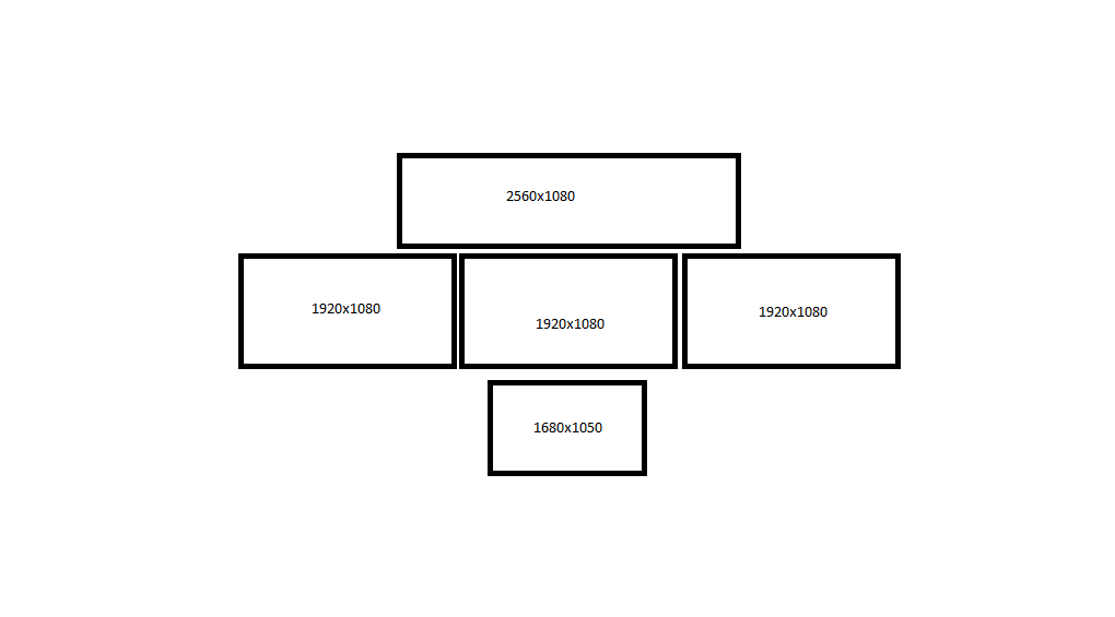

There would be 3x 1080ps (5760x1080) yes, although I may add a 4th 2560x1080p for a top view later. and also a small screen for MFD's
Something like below..... (excuse the paint skills :) )
Like this guys, but obv newer monitors, BMS insn't demanding really so one 290 may be enough, I can but try :)

thats awesome ^^^
