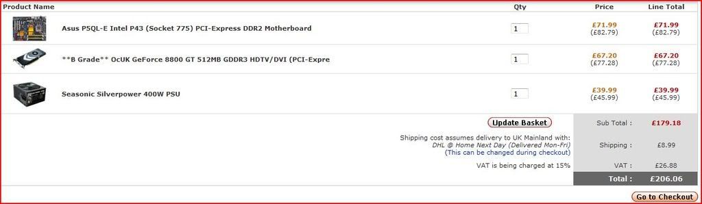

well i will buy a better PSU later on in the future, i got £200 spare in my pocket so might as well buy the new PSU now?
I'd look at something like the OcUK value 9800GT with a view to clocking it, it's just a shade over a £100 and would give you more options with regards to more memory or even a new board that supports PCIe x16 and possibly more overclocking headroom for your CPU.

yeah, maybe the 8800GT is a better option, then you can maybe look at getting a better motherboard and CPU
I built my son a new rig for christmas with a 350w Silverstone PSU and that's been happily powering a BFG 8800GT and a E6600 with all the usual gubbins and he's had it on since christmas day. I honestly think you will be perfectly fine with your PSU.
If it were me i would sell the Geil 2GB DDR2 ram (2 X 1GB), Leadtek 6800GT 256mb and E4300 @2.8ghz You should get about £80 giving you £280

I'm with you on sticking with Nvidia but you may get some who say a 4850 is a better buy. either way i wouldn't worry about your PSU and Antec make good units.
I'm with Pumaz except I would drop the 4gb and stick with your 2mb and put the money towards an E8400, the Asrock board you have is ok at overclocking for a budget board but not fantastic, so the extra cache and mhz at stock would be welcome.
4 x PCI-E isn't going to make huge differences to things, maybe with top end cards with masses of ram and huge displays you could possibly lose 10% or so, but with a normal 22" display it's not noticeable.
The £103.00 9800gt would be fine for your purposes too, the GTX is 30% dearer but no where near 30% faster and the GT would still give you an up to 400% increase in the framerate over your old 6800gt

You could also go this route
2nd hand - 8800GT = £60
2nd hand - Q6600 = £100
New 4GB Memory = £40
New Mobo = £40
Just raise the extra buy selling off your parts but i still say you don't need a new PSU
