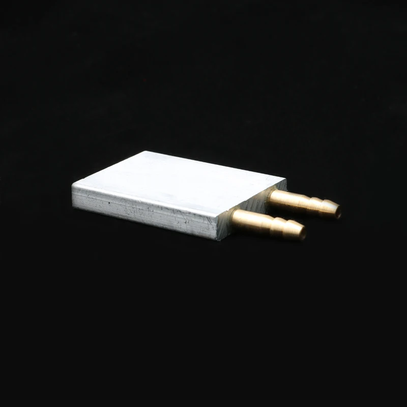

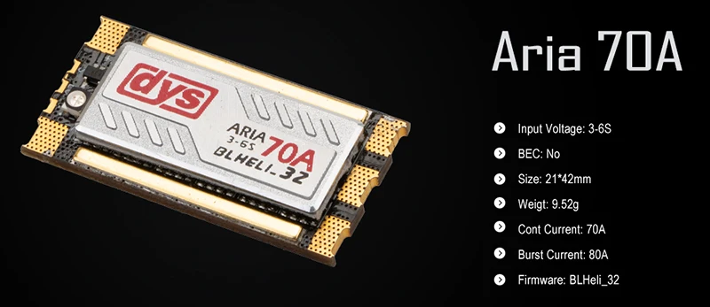

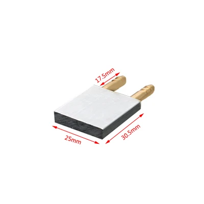

Hi, What is the way to connect/attach this watercooling plate 25*30mm to this BLHeli ESC 70a 21*42mm to get the most cooling efficiency?

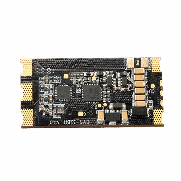

How does the board interface?
Id be tempted to cover the underside with a rubber insulative barrier and then use 2 pairs of bars with threaded rod and nuts as a rudimentary clamp system.
This board will interface on the right side with 3 cables and on the left side with 2 cables. I have found an image to illustrate this and the cable size:

Is the water block being applied
Directly to the silver heatsink already on there?
If so get a couple of different thicknesses
To account for holes or indentations
Or make sure to get more pads than needed
And slice little bits off and fill holes/indentation first
What thickness would only be a guess
No experience with one of those at all
I would probably get 1.5mm and 2mm
They're Cheap enough anyway
Good question, I am actually wondering if such heatsink can be removed? If it is possible, I would prefer removing it to be able to place the watercooling directly on the board.
If it is not possible, I need to place the water cooling on top of it. Is thermal paste able to fill the holes/indentiation of already present heatsink? I have neved used one til now. This might be necessary before applying the thermal pad.
Yeah ideally I would remove the factory heatsink if possible
But then you may be similar to gpu waterblock
Ie needs more than 1 thickness thermal pads
Plus it might be stuck on with thermal adhesive
That would rip stuff off trying to remove it
From the picture they look like shallow indentations
I would think filling those with thermal paste
Then applying thermal pads would work
Can't guarantee it
But would I personally try that
Yeah have to say I would give it a go

This board is normally used on a drone, so a lot of airflow goes naturally over on it when in use. You can see it as an active cooling system in fact.
Cooling this board is very important because quite a lot of energy goes through it.
I want to use this board inside a 30cm small boat, where there is no airflow at all, so I need to use water to keep it cool.
The shrink wrapped on the photo above is more an easy and cheap way than a solution. I am afraid the board, thermal pad and watercooling plate might not be enough in contact with it as the boat vibrates when in use.
I would use the heatshrink method which serves as a first fix and electrical isolation and then secondary clamp/cable tie to get some clamping pressure.
For thermal interfacing the cold plate to the existing heatsink thermal pads seems the most sensible option. The heatsink wont be anywhere near flat enough for a compound and has channels in for thermal compound to escape into under pressure. If the device can be passively cooled with airflow on a drone I dont anticipate you needing insane thermal conductivity to get an effective cooling solution under water.
At least if thermal pads dont work it will be easy enough to remove and clean to try another option.

2 lengths of aluminium C profile, some captive bolts and nuts would be a rudimentary and relatively lightweight clamp option. Still the same consideration as to what you clamp over on the PCB to avoid damage however.
You could even consider integrating the clamp into a fixing system in the boat and get dual purpose
Do you have an image of the aluminium C profile you are considering? I haven't seen one yet.
You are correct that I also need to take care of the PCB. Using a part inside the boat is a good idea.
I am considering another solution to hold the water-cooling block / thermal pad / PCB well together: is there some thermal conductive single-sided adhesive tape? I could use it to keep this together. The force would be better spread around all parts than a cable tie and resist boat vibrations.
