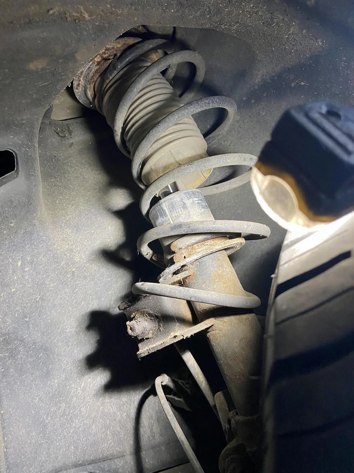

As Andy-mk3 said, that spring could easily drop off the cup and stab the tyre (I've seen it plenty of times).
Here's one I failed today showing exactly how easily it can happen..
That spring is barely holding on before it slips, and imagine doing 70mph when it does.
I did try to explain to the customer how serious it was, but she said she'd book it in next week for repair and re-test.

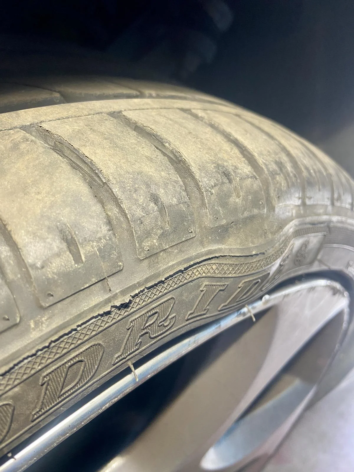

Impact damage to tyre sidewall..

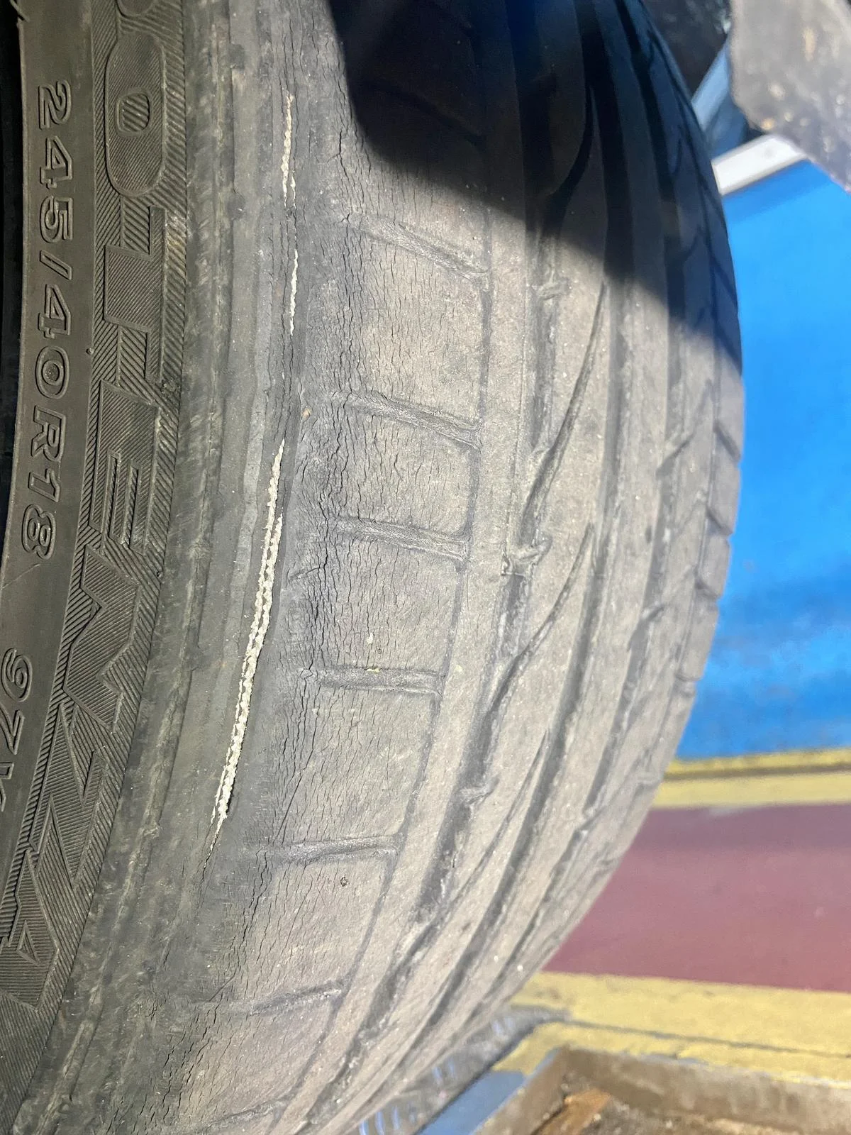

Cords visible..

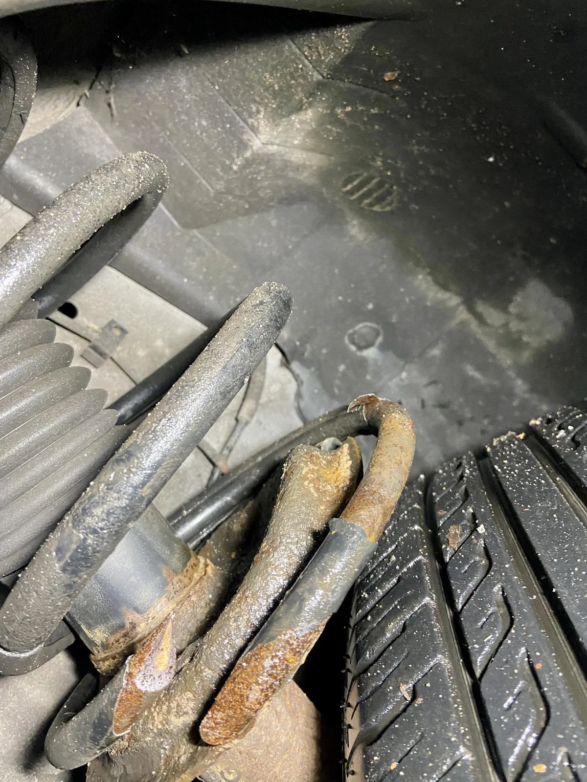

Yet another broken coil spring..

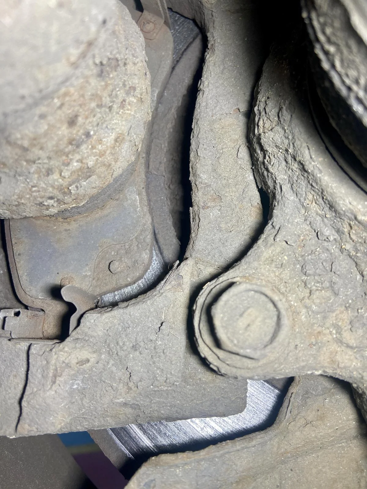

And front brake pads metal to metal with the disc.
What never ceases to amaze me is that (in this case) the owner completely ignored the initial noise from the metal brake wear indicator (which is loud as hell) and continued to drive it, and then presented it for todays MOT and was surprised when it failed.

It's quite an eye opener, I think (as a person who's into car), maybe I've put the intelligence of the "average ower" a bit too high :p . The one with the cords looks like it's almost up the sidewall from that angle, was it just badly aligned wheels, or do they need to corner faster (it is an issue on my old 911, honest).
The tyre with the exposed cords was on an old E Class which had lowering springs fitted, and also had excessive play in the track rod end and bottom suspension arm ball joint.
So, yes, it was an alignment issue in every way possible.
