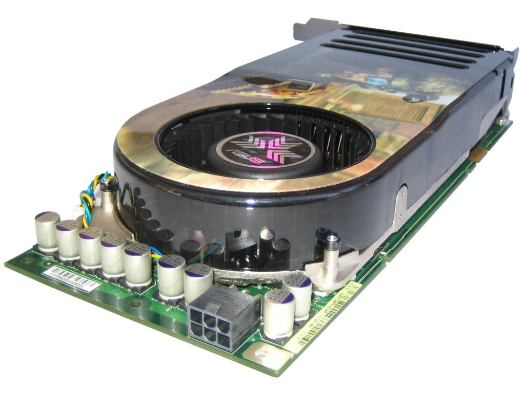

Also, there is a 6 pin power cable labelled "PCI-E" from my PSU. But I dont know where it goes?
There are no 6-pin slots on my mobo. But I don't think power is required for my PCI-E x16 GFX card, its not very demanding.
Some graphics cards such as this require a 6 pin PCI Express power cable. <note black 6 pin plug.
Low end card don't use it...say here...
Both of our cards, the 8600 GT and the 8600 GTS, feature two DVI ports and a 7-pin video port. The GTS requires a 6-pin PCIe power connector, while the GT is capable of running using only the power provided by the PCIe slot.
