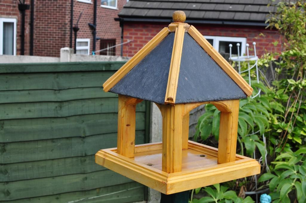

Looks great! I like how you have continued the molding on the roof corner covers around to the front edge. Glad someone found it useful :).
with that part I imagine it was made in 2 parts, top and bottom. You would build the shape then route it once built, then glue them together. You'd mount the router still and move the wood around the bit using slides.
Just guessing but I think that is the way I would do it.
I have a cheap router table which makes it a lot easier. I screw a piece of scrap plywood to the fence and then move the fence with ply toward the cutter so that the cutter goes through the ply. This means there is a continuous fence for the workpiece to be pressed against and reduces the chance of the part getting stuck between the cutter and fence and then being flung back. I'll also take a few passes, so that a small amount of material is being removed at a time.
If I was to do it without a router table i'd screw the work piece down and add some same thickness material around the work piece to support the router base and stop it tilting and use a cutter with a ball bearing to follow the shape.
The very small chamfered piece at the top would probably be best done by hand with a sharp block plane, or with a file/ some rough sandpaper and a block of wood.
The part in the middle is what you want to shape. Screwed down to stop it moving. Then a piece of scrap wood of the same thickness placed around the workpiece (also screwed down) with a hole cut out to allow for the workpiece, plus enough space to allow a channel for the ball bearing of the router cutter.
My sister moved into a new house so i am making her a bird table as a moving in present. Decided to try an easier way of constructing it as the last one took way too long with all the dowel joints. Managed to knock this up in a day so far, so a lot quicker to build.
Quite pleased with this one, I think the proportions are better than the last one i made. She is coming to visit in a couple of weeks, so I'll leave it bare wood and let her pick out a colour as I think she wanted it painted rather than stained.

Liking the new bird table. Slate base is a good idea as the plywood is always the first thing to rot.

Finished until my sister comes to visit and picks out some paint. Hope she doesn't go for some horrible colour like pink :eek:. Think green or cream could look ok.
Went for a cartoon nuclear missile for the spire on top :D
