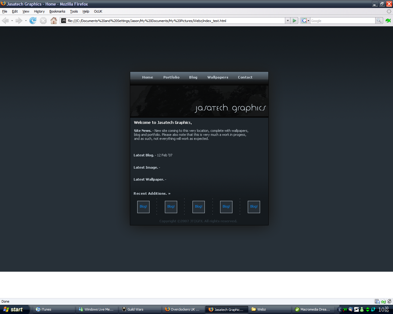

Right, so I've split the background, and left the original in, the background now goes right across horizontally, but not vertically, leaving a white gap at the bottom, any ideas?
Pic

Code:
<body leftmargin="0" topmargin="0" bgcolor="#ffffff" marginheight="0" marginwidth="0" style="background-image: url(./images/background.gif); background-repeat: repeat;">
Works for the home page, but none of the others. :confused:
Do I need to remember how I got the first one to work, then do that to the rest?
Thats what it means when I'm about, I'm sure someone with some more knowledge and skills could do a better job compared to my dogs dinner, but its a side effect of a image based site I spose.
Sorry forgot about this thread. Personally, as you have a simple design I'd switch to CSS before it gets too complicated. It'll be worth it. In the meantime:
Code:
<body leftmargin="0" topmargin="0" marginheight="0" marginwidth="0" style="background-color: #273038; background-image: url(./images/background.gif); background-repeat:
added a background color.
