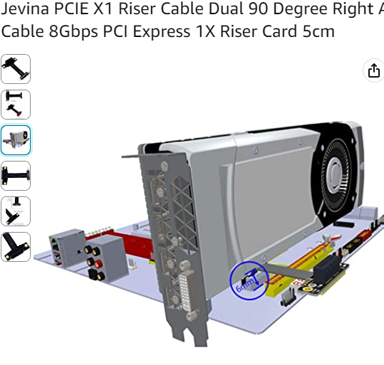

Mobo i am using is Asrock h510m-hdv/m.2, card is right over the pci, reason i was thinking if riser would be the best solution
I can see that mega-rare risers have usb slot on the side and not the top, the only one that might/should work, not entirely sure if ribbon cable would work but cant see why not
Not really considering USB adapters as they are pants
Unfortunately OcUK don't sell anything suitable (only PCI-E 16x risers), but it does look like there are some available elsewhere that might work
e.g. this design only protrudes from the slot by around 6mm, so hopefully would fit:
