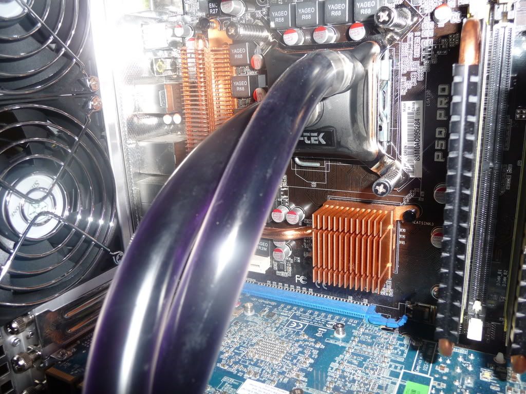

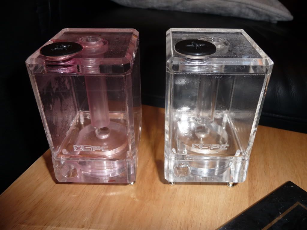

i would avoid dyes tbh but if you are going to use them Mayhems is far better than any others, i have used various dyes (not Mayhems though as i decided colored tubing was better) on one rebuild i noticed the water was clear and my clear tubing/res/block had been dyed..and i thought i still had coloured water.

Most if not all clear tube will leak plastic stuff into the water that is then collected on the tube walls as a white film, this is then stained red with a red dye.
