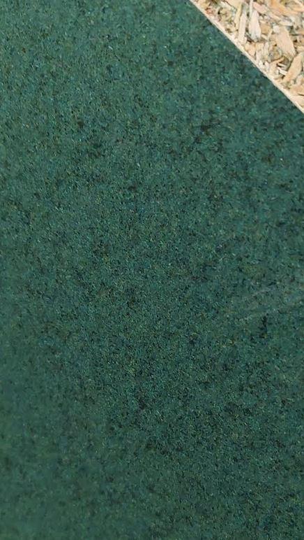

Ordered some chipboard from Wickes, to replace some flooring, have bought some previously with no issues but this time, look what's turned up:
Looks like a snooker table! Slight sheen to it and it's smooth. Any ideas?
Edge shot:
I'll get on to customer support but until then, what's the deal with that? Is this normal??
Edge shot:
Its just MR board isn't it?
