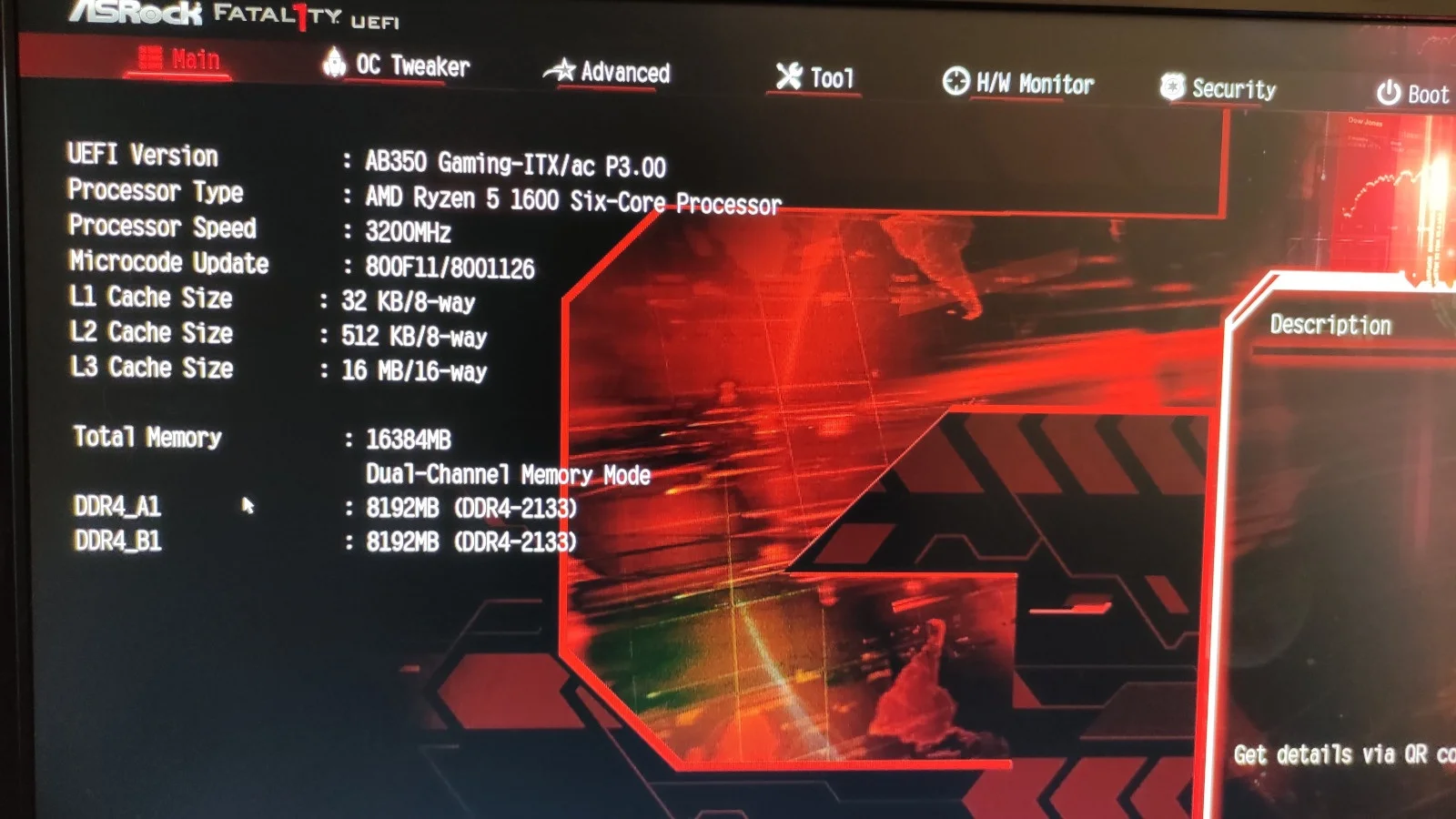

on a lot of the first gen 3200mhz ram as way more then they could run, my 1700x was maxed out at 2666mhz.
try lower the speed a little

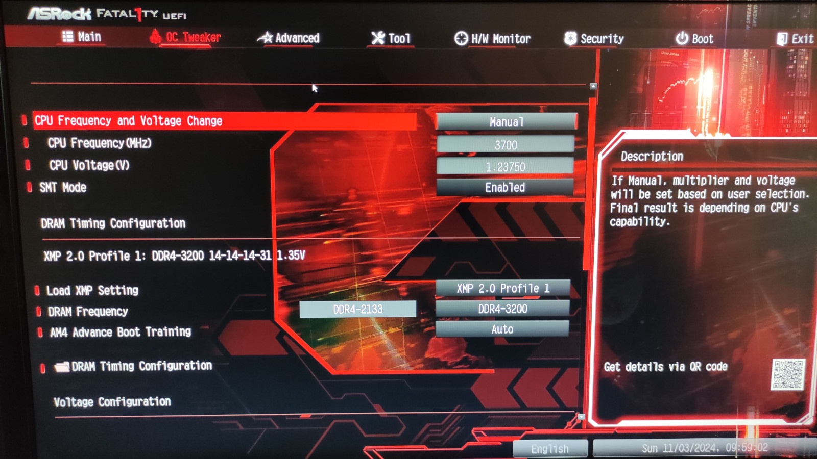

set XMP then lower the speed to 2666 and or try 2800 remember if infinity fabric should be linked to ram speed too

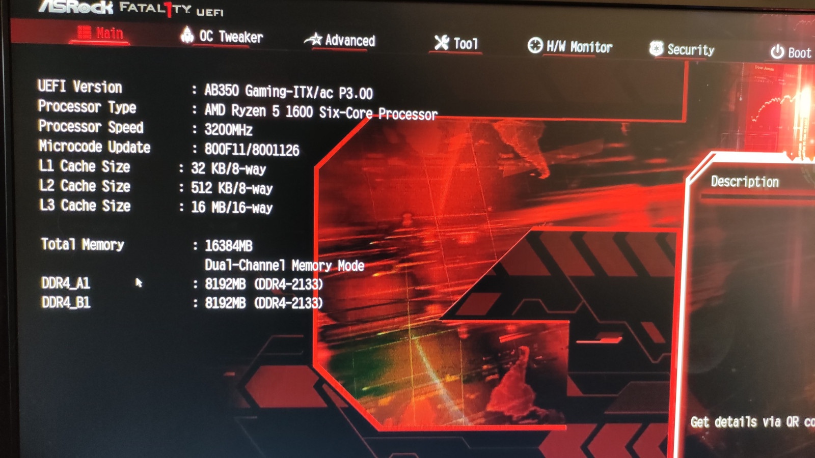

also your bios is massively out of date, your running day one bios

no i would use XMP then just drop the speed down.
as its been running good for 6 years it could be a vulnerability fix put out via a windows update that just not liking your very old bios
https://i.~ibb.co~/gRwn8cN/Screenshot-2024-11-03-163154.png

I tried turning XMP to auto and the system booted straight into windows, so for some reason it doesn't like the original XMP profile any more.
I'll try turning XMP back on with lower frequency, will I have to adjust clocks also, or should i try keeping them at 14.0
I'd keep that at what XMP set and just see if it boots at a lower speed.
TBF with a 1600 on B350 board and day one BIOS i surprised you ever got 3200Mhz to work.

I seem to remember an early issue with this board of it bricking when people tried to flash with a newer bios, which is why I never bothered, I then forgot all about it to be honest.
