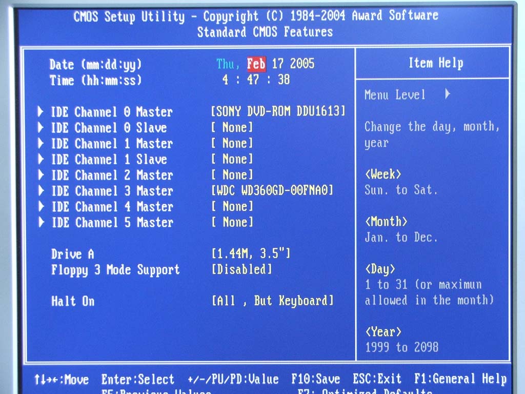

I got into the cmos setup screen, pressing ctrl+f1 did nothing. but i guess that the hdd has had it.
yes i tried this, however i got a message telling me to make sure my HDD is powered and connected, which it is connected and so should be powered.

ok the only one in standard cmos features is my CDRW. and that is on channel 0 master
