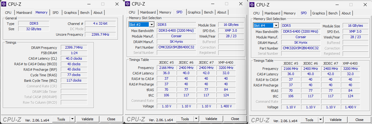

Hi guys, I have been testing my new pc I just built yesterday. Everything runs well but there is one thing I overlooked with RAM. I bought Corsair DDR5 Vengeance 6400 cl32 2x16. And it says it's optimized for intel.
In my bios it shows speed of 4800 even less in cpu z https://i.postimg.cc/Twj6c1qJ/1.png. How should I configure it? I played some games and ran full memtest86 with these default setting and it gave 0 errors. I'm amateur at overlocking. Should I consider returning for different ram?

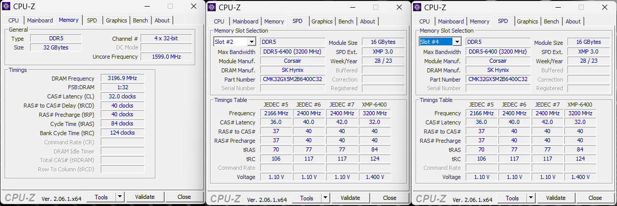

edit: I turned on a-xmp profile on in bios and got 6400 cl32 on auto. Is it safe to run it on my system? should I do another memtest86 with it on? https://i.postimg.cc/5tqktRBn/2.png

I just turned A-XMP on in bios. Do you think there is any issue running it on amd system? Does this look good? https://i.postimg.cc/5tqktRBn/2.png
Nope no issue what-so-ever, im running intel optimized DDR5 on my AMD system
