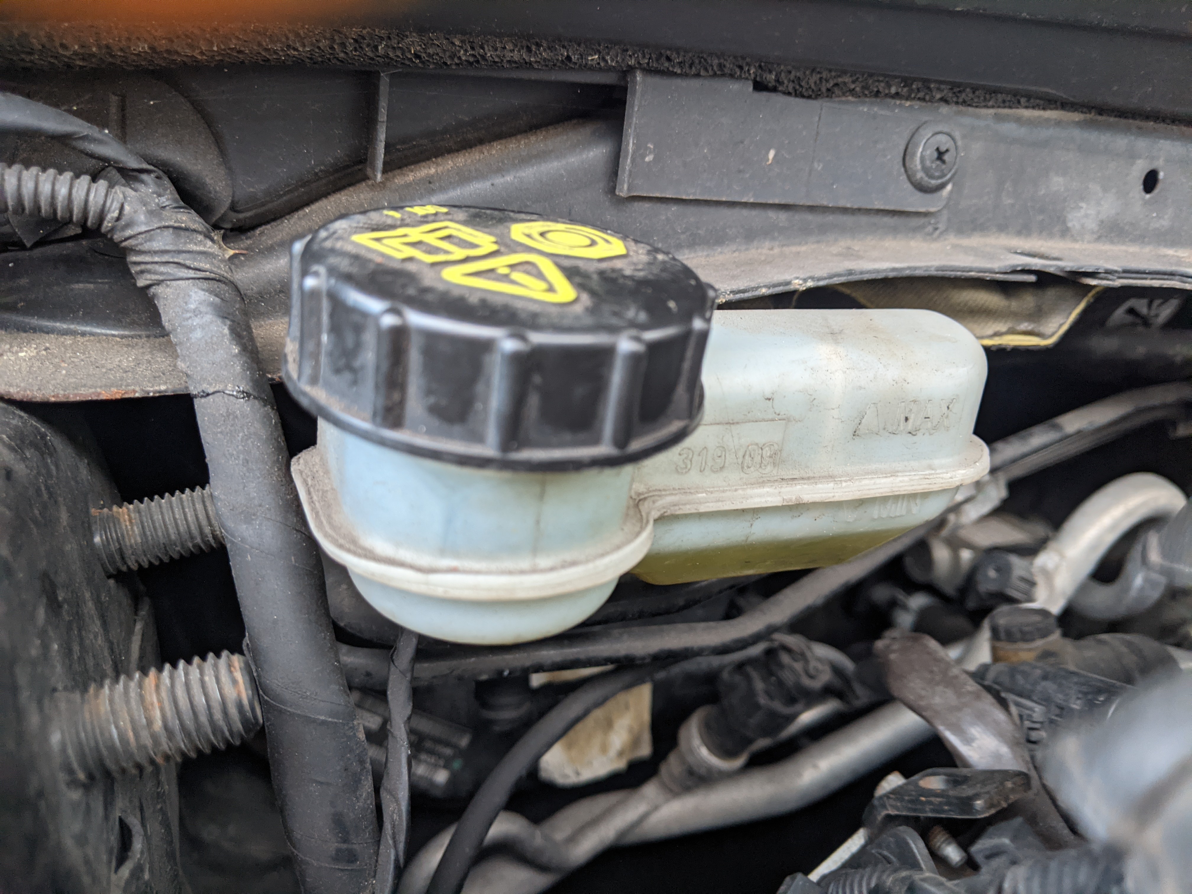

Hi,
I tried to top up brake fluid on my Mk4 Mondeo but the fluid is not getting into the main reservoir from the cylindrical section. The brake pads and discs are in good condition so wondering what is it that I am doing wrong. Want to check if I need garage help for this.
I have tried with starting the car and pumping the brake pedal but that didn't help. There are no issues with the brakes, I just happened to notice the fluid level was low.

I can see the level on the first pic where it is below minimum. Not sure if the camera angle helps it. I do remember from memory the level used to be up.
Just top it up to the max level, and if you're not sure or can't see it properly, hold a torch behind the reservoir, like..
You see how in your car the filler sits on top of the reservoir. I mine it is to the side. I did watch a few videos on how they fill the brake fluid, but these were fluid replacement videos.

Just top it up to max line, small arrow on the right hand side of the reservoir, it’s no more complicated than that.

Well... I tried topping the fluid up to at least have it between Max and Min levels. But on adding the recommended Brake Fluid it did not flow into the reservoir. It just stayed there in the cylindrical bit. I expected it to flow into the chamber on the right with ease.

Oh, I get it, you mean the white filter that sits underneath the reservoir cap?
If it’s just sitting in the filter, then there’s enough fluid in there, as the filter takes up some room.
I assume you’ve removed the filter then took the pics?
I haven't got a Mondeo on site, but this pic is from a Fiesta (which should be similar), does this look the same as yours?
If the fluid you're trying to top up is just sitting in the filter, then there's already enough in the reservoir.

Nope, it's different to mine. Thank you for checking though.
