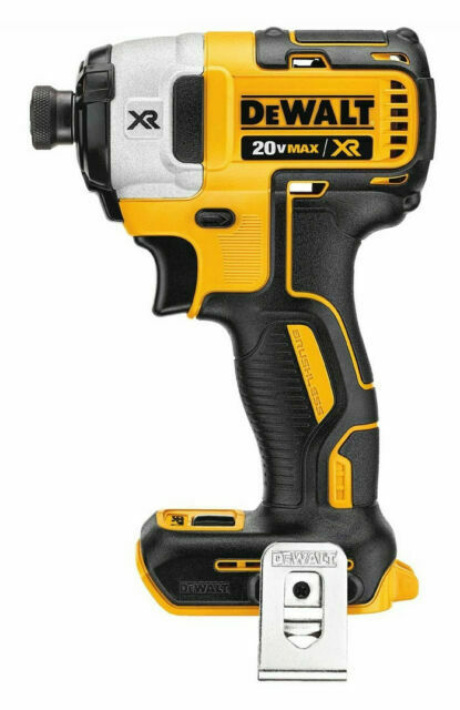

How did two manage to break, or you using one of these to put them in..?
