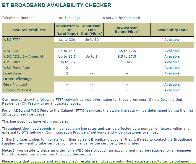

It's possible that where you live isn't in the trial area since FTTP through plusnet isn't available generally (however you should use the BT wholesale checker for your address to see if FTTP is actually available to you).
thats what it says, I assume that means I can get FTTP?
Seems to suggest you're on overhead cabling as well.
what does that mean :confused: I was told they are going to be digging up the pavement for the Fibre. Or are you talking about my current ADSL connection?
I am hoping the engineer will put a whole new master socket in as currently the master socket is in the rear of the house, but the Fibre will be coming in through the front, at least I assume it will be.
The fibre may go under the road for some of its journey where it will join a DP (telegraph pole). From there fibre will go overhead to your house, replacing your current copper drop wire (or in addition to).
