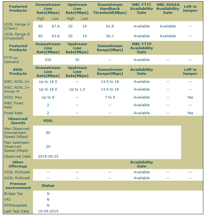

Quick question. Ever since I had fibre installed (a few years) it's been running at 80Mbps. A few weeks ago my internet kept flipping on/off all day and struggled to get sync - I think they were doing some work on some new houses being built by the exchange.
It was only syncing at say 30Mb then eventually it sorted itsself out but only resynced at 76. I left the line connected for a week and tried rebooting to no avail.
I called BT who basically fobbed me off, "You're only guaranteed to get 55, anything over that is "amazing", go away".
Is there anything I can do? It makes all the difference if you're downloading large files.

So the checker also features a 'live' check and you can see this, it's seen 80/20 on 25/09. Your speed should come up eventually but might take a week or two more.
Ahh I missed that, thanks. Am I right in thinking the exchange will automatically keep trying to regrade my line, or do I have to ask for it to be reset at some point if not?
DLM should keep checking your line and once it's sure your line can accept the improved speeds it should reprofile. Might take a couple of weeks though and resist the temptation to reboot or reset your router.
It’s just under 18 minutes to download 10GB at 80Mbit, it’s less than a minute longer at 76Mbit, it probably took you several times that to post what you did. BT are quite right, it’s not below the handback threshold and it’s only nine days since a full 80/20 was observed, leave it alone so DLM can do it’s thing and stop being a drama queen.
Thanks for the input all :p, I'll keep an eye on it. I was more curious as to what went off to cause it to all haywire to honest.
I spoke to them prior to that 80/20 sync they only just called me back today.
