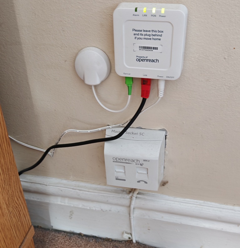

I had BT FTTP put in November (after a lot of hassle but thats another story) and I resisted switching to EE even though they push you that way as BT Internet is becoming EE and the install was fine. Engineer took about 2 hrs to install.
Bottom box is my old BT copper/FTTC connection. Top is the new FTTP box. No need to alter any of your internal wiring it just plug router straight in like you do with the BT Copper/FTTC connection. All you need is a power socket which is not a problem. I actually went for the FTTP 900 package (with a healthy discount) and I`m actually getting well over 900 Meg often over 1 gig.

Thats an interesting photo. If i knew someone who could have showed me that, it might have made a difference.
However, the power point is about 3 feet away, and it already has multi sockets for TV, Freeview recorder, hifi amp, DVD, and an equaliser.
Then I would want to receive the actual broadband to my desktop in the spare back room, which is currently hard wired from the front socket equivalent to yours.
I don't see an output wire from your socket though, to connect to this router via the similar socket in the spare room at the back of the house ?
The output is the black ethernet cable, that goes off to a router.
Think of that ethernet cable is being the replacement for the cable that would have previously run from the left hand socket on the (disused) box at the bottom of the picture and the router.

With FTTP your internal phone line extension is defunct, you need a cat 5 / 6 network cable from the box on the wall to the router; most Virgin installations still use COAX which goes directly to their router.
That said the installers should install it where you want it but might charge extra to run a cable to your backroom.
