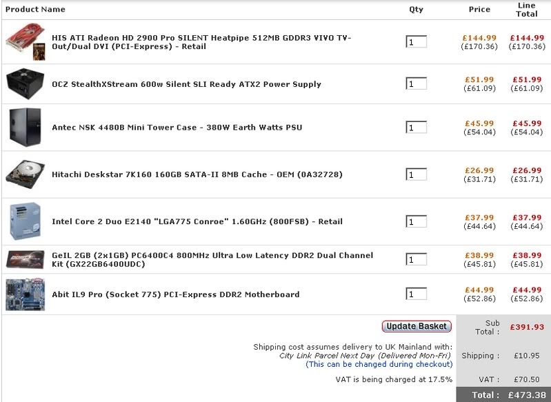

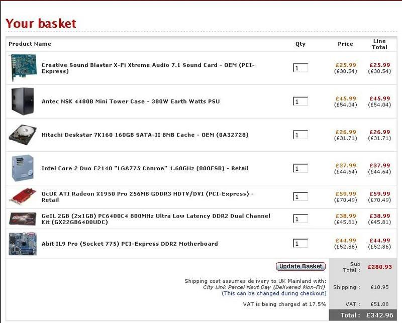

ok ive done this in 2 lots the first is well under budget and a good all rounder and the second is a kick arse machine for the money but £20 over budget allthough its well well worth the extra £20
firstly
secondly
in the second one ive thrown in a beefy psu to handle the 2900 but the first machine should cope fine on spec and has a sound card also to give it a better angle for its money.
the second one is great value for what it is and should give moderate oc's on the cpu and the pro should hit xt speeds no bother atall so your friend will really do well for his gaming plus it has 2gb of ram so should be stable for a good while.
edit***
just a quick review on my second spec with the 2900, replace the antec case with a lian li pc7 aluminum case and youe laughing its £5 on the budget but the case is in a completaly differant league as you dont need the psu in the antec.
