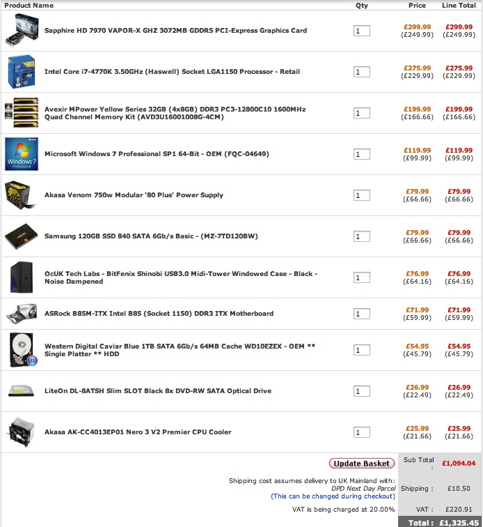

Hi guys, finalising my PC build, would love it if you knowledgeable people could check it out and make any suggestions in terms of compatibility and if i could improve it in any way. Also if anyone could suggest a good case please.
Also if i could make it any cheaper without losing much performance that would be amazing.
This setup is intended for 3D modelling/rendering, design etc. as well as gaming.
One last thing, how do i post the setups in the nice neat list like you guys do?
Many thanks :)
Thanks for the input guys, I think I'm set on the 4770k just for the raw processing power that i require for my work, coupled with the 32Gb RAM. It's just choosing the mobo and RAM that are all compatible with each other.
Last 2 suggested builds are spot on, thanks guys :) are there any suggestions on things to change/remove to lower the price a little? I know im asking a lot with the specs im aiming for.
If we take RJC's build, really the only option for money saving is to downgrade the PSU..
If you not looking at Xfire in the future this is a valid option, but if you are its well worth keeping the PSU..
