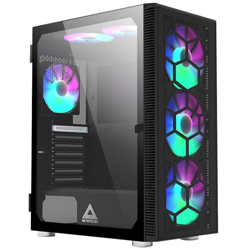

Hey guys, I used to know computers inside out but have sat on the sidelines since I built a mini tax about 10 years ago and a few things have changed.
Would someone please check over this and let me know if I've gone overboard on anything, and if I'm missing anything from the spec that I'll need to get this system firing.... besides an OS.
tia. J
Edit - I should probably add what I want the system for. Mostly life admin type stuff, less interested in gaming but I am interested in playing with Unreal Engine. I also do a fair bit of video editing and after effects tasks.

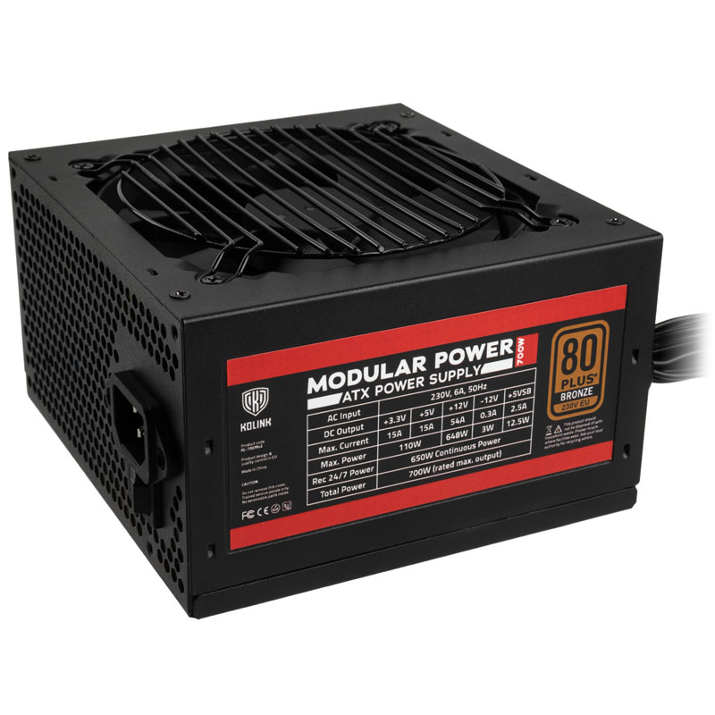

12700K and a 3060 12GB are not bad choices for your usage, the 3060 is a bit slow nowadays, but was a popular card for creativity and still does the job.
I would recommend getting a better PSU and dumping the hard drive for a 2TB SSD.

Thanks for the advice appreciate that. Could you recommend a PSU? And reckon it's worth using the £100 from the 12600K on an upgrade on the gPU, would you recommend this too please? Thx

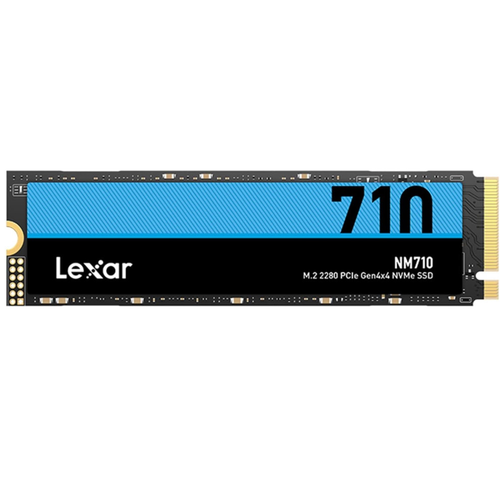

That's great thanks. The M.2 memory is new to me, I'm presuming it's just a new faster type of hard drive?
SSDs (either M.2 NVME or 2.5" SATA) are waaaaaaaay faster than hard drives, but it depends on what you're doing with them. For archive storage a hard drive is still fine, but I wouldn't want to game on one, or to load very large projects.

I'm used to the SSD SATA type drives, I use them quite regularly at work especially in caddies on USB3/C they are speedy. I'll stick to the i5 then in that case thx

Yeah, there's not really an issue with SATA SSDs, but I wouldn't buy one if a M.2 slot is available to you.
it's mainly neater, they slot straight into the motherboard so less work than plugging an ssd into the system, and routing wires to it etc, yes they are fast, but not really any faster than a SSD, they are an SSD on a stick rather than an SSD in a box but much faster than an HDD just like an SSD is , though I would advise watching a youtube video on how to actually fit them, as it's not just totally simple plug and play until you get used to installing them!

I think with the more modern titles you are seeing a difference now between even a raid 0 SATA SSD setup and a decent NVME M.2. But it's not huge.
