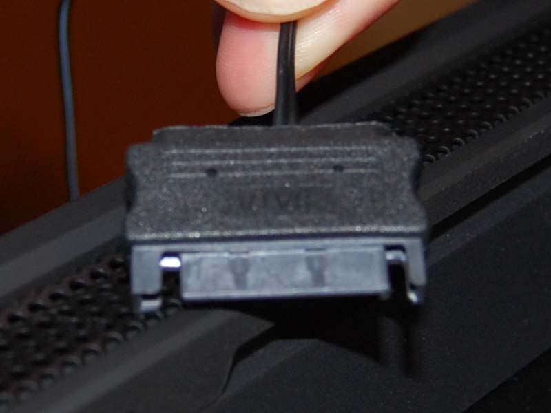

This is one of the case cables in the switch 810, I think it is from the SD card reader. It appears to have the word SATA written on it, but it is not going to fit in any of the standard SATA 2 or SATA 3 headers used by the disk drives.
My question is where do I plug this in or what cables do I need.
I have an Asus P8Z77-V deluxe mother board.
