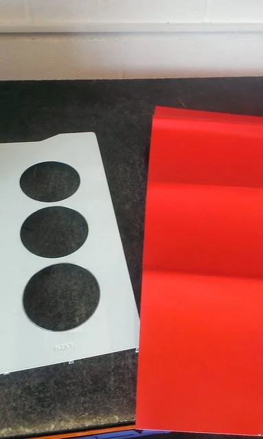

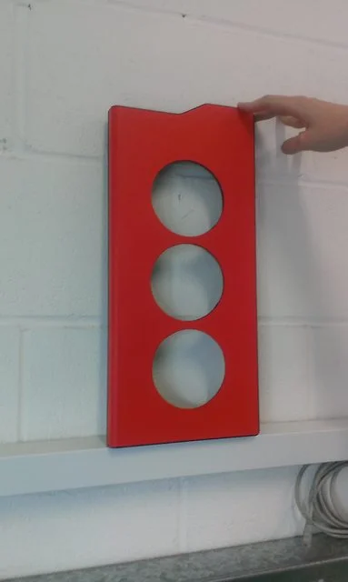

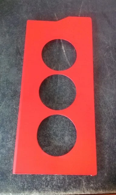

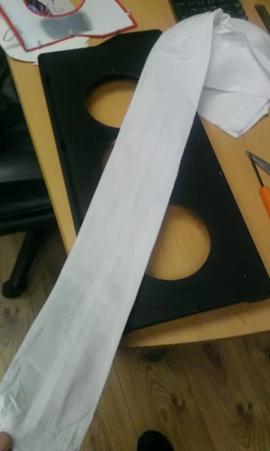

so lets get started. you have all seen me cutting holes so far, here is an update (not 100% done with the front panel yet, but we will see soon!)
front with all holes cut
the plan!

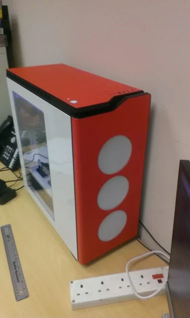

metal panel all wrapped up!
with front cover assembled

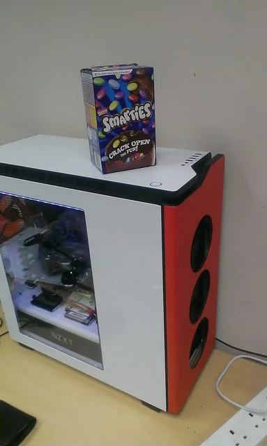

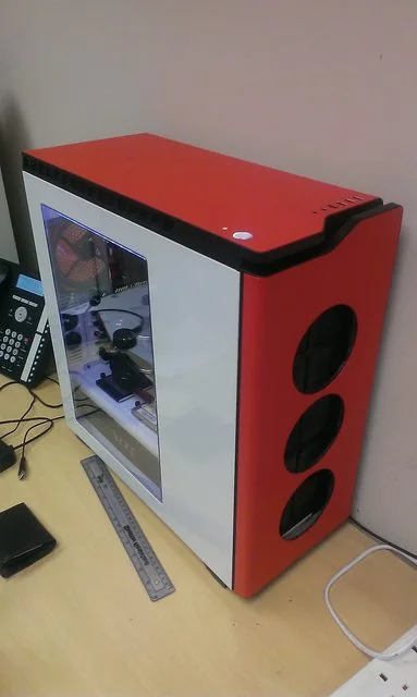

how it looks on the case...
I am still not 100% happy with it, it will have to come apart for me to fit my fan filter mesh in so i may decide to strip the wrap off and plasticdip it. any thoughts/experience with plasticdip?

That looks superb mate, I love the colour combination of the red and the white, I think they go really well together. You must be getting some cooling benefit from those 3 fans now?
well now my gpus run at 51 degrees when mining (max load for a few days), VRM temps are 46/47 degrees for card 1 and 47/48 for card 2. not bad for a couple of 290x's xD
I think the wrap looks good,
I prefer wrap over plasi as you have to get the coat nice and even and a spray can's hard (for me) I use an airbrush to paint so cans are a bit of a struggle

can i say that working with this metal sheet is damned hard without a pillar drill. if you can get access to one, do it! also note that the metal marks very easily as well as the side window (cheap ass polycarb from what i can tell).
you may want to steal my idea for front fan filtering if you plan on modding the front panel. once you cut holes, you see the nasty looking fan grills that are there. going to use some filter mesh between the front panel parts (between metal and plastic) and use some 20mm shrouds (think i measured it correctly, they should fit nicely!) to direct air flow so it pulls through the filters at the front!

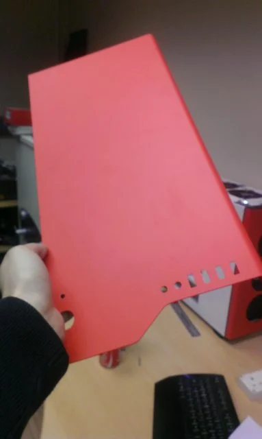

small update: second sheet of wrap has arrived. stay tuned for pics of the top heat wrapped!
here's the top metal panel wrapped
top panel assembled (did wrap the buttons, but decided to leave them white in the end to tie it in to rest of the PC)
the PC as it is right now...

update time! still haven't got the side window sorted. keep forgetting to take measurements doh! front cover is pretty much done though. still need to get my shrouds too but i don't mind that!
