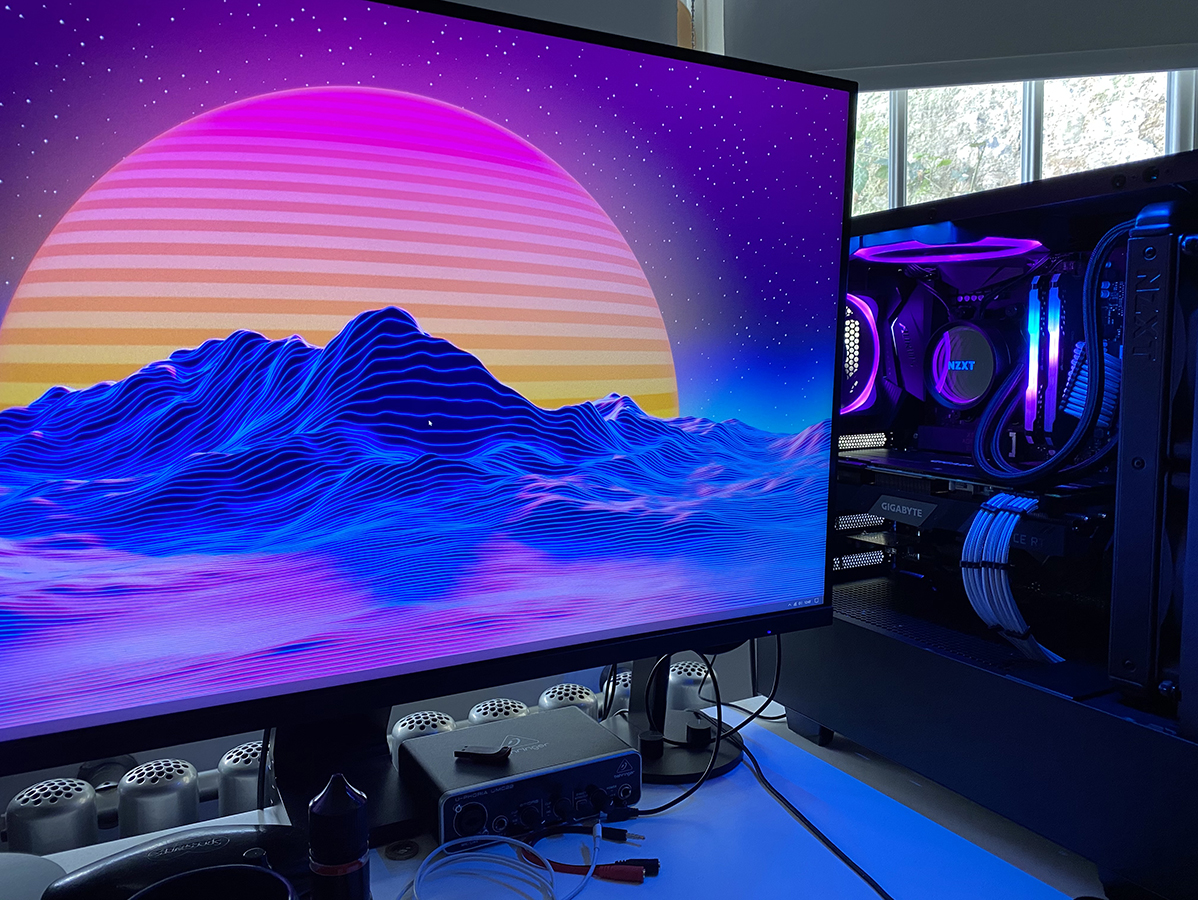

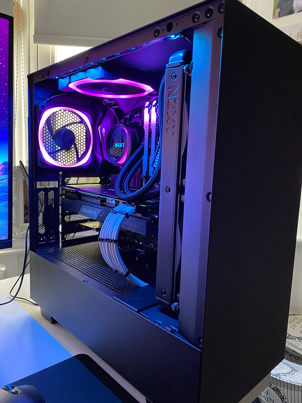

**EDITED POST BUILD**
Heres the final build, with garish retro RGB because why not.

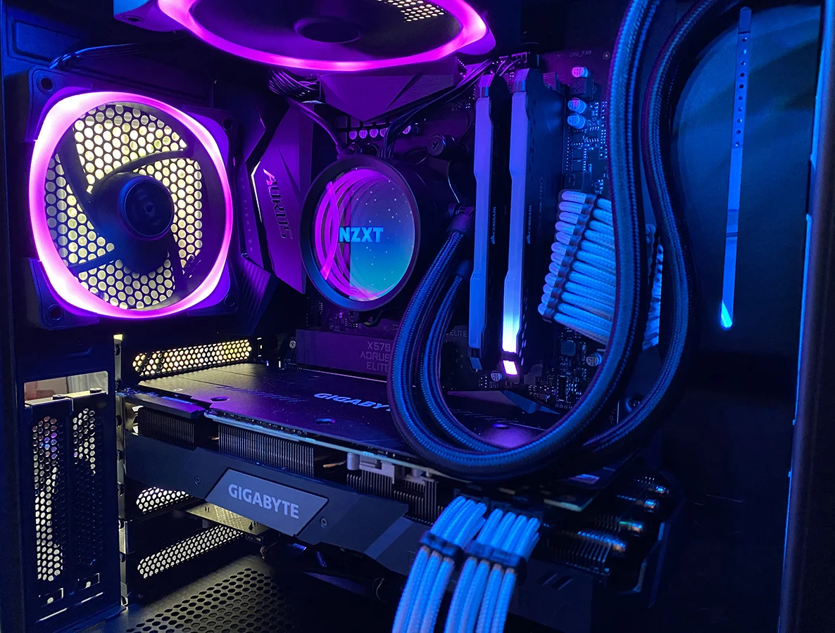

From experience with this build, I'd not rely on having that USB-C port on the front panel as the header jack on the motherboard is directly behind the graphics card and as such can't be plugged in. Also this Gigabyte 2080 Super sits FLUSH (and I mean flush) with the chipset heatsink/fan. Just something to think about.

Yeah all done. Just finalising overclock now. It’s stable at 4.3GHz at 69 degrees full load so happy with that. Corsair memory isn’t the best for OC I’ve noticed though. Can’t squeeze out any more stable frequency, just timings, down to CL14 currently

Original was CL18. Corsair uses Micron E-Die which I don’t think is as flexible as Samsung B Die if I’m not mistaken.

Will give a full edit on original post with photos and some build shots at 2am last Thursday...
