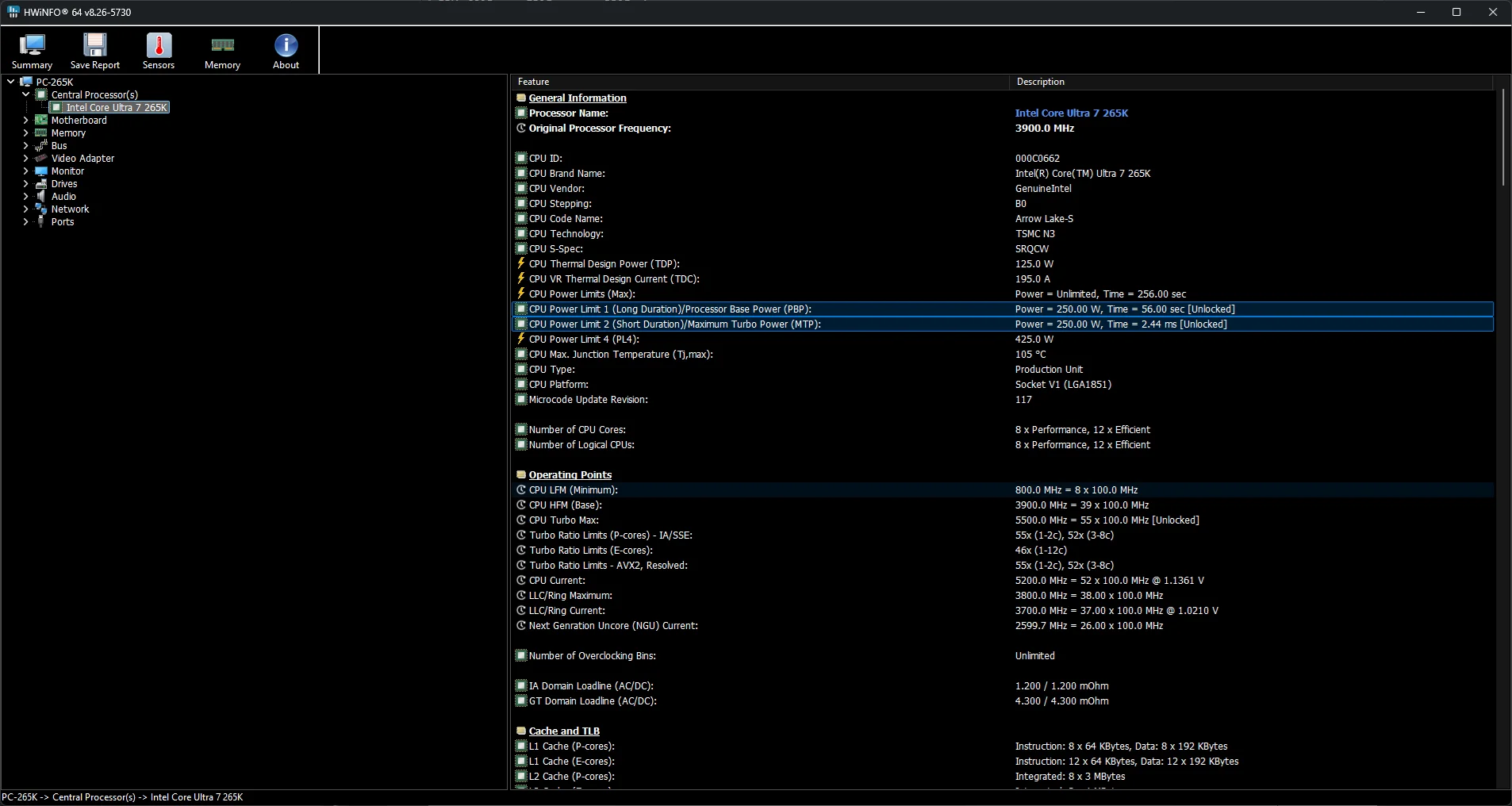

Since the raptor lake issues I'd be very surprised if motherboards still run them power unlocked "out of the box", so it should conform to the stock numbers (PL1 125/PL2 250). I believe hwinfo will tell you what your motherboard currently uses for those numbers and you can match that to the actual power of your CPU (in watts).
To me it looks like PL1: 250, PL2: 250
So it differs from the expectation of 125/250
Is it just a case of finding the PL1 setting in the bios and changing it, or is there more to it?
From what I can gather in the launch articles, Intel no longer have a limit on how long the CPU can boost to the higher number, so in reality they're both 250.

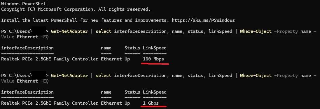

Ethernet speed issue
I noticed an annoying issue while downloading games, the motherboard's Realtek ethernet speed is inconsistent, sometimes it's 1Gbps sometimes it's 100Mbps. Once it picks a speed it stays that way and works, so it shows 1Gbps works, the issue is just that sometimes it chooses 100Mbps instead.
Context
I know the rest of the network is fine because the old PC was always 1Gbps, same cable and everything, only thing that changed is the PC.
I'm on YouFibre 150 and thinking of going to 500, so want to get this fixed.

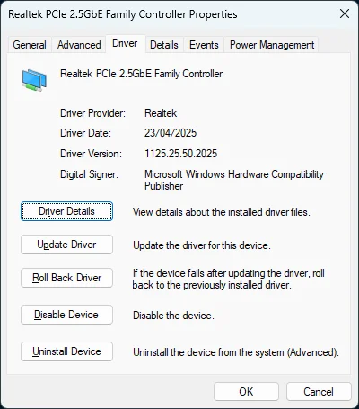

Driver
I have the latest driver from the ASUS website:
Realtek LAN Driver V1125.21.903.2024 for Windows 11 64-bit---(WHQL).
Version 1125.21.903.2024
27.45 MB
2024/12/09
I tried downloading these files from Realtek:
  • Win11 Auto Installation Program (NetAdapterCx)
  • Win10/Win11 Auto Installation Program (NDIS)
but they both are a zip which contains an exe which when double-clicked nothing happens.
Edit: That was Microsoft trying to limit me to only installing apps from the Store, which became obvious when I tried to install Samsung Magician instead. I installed the Realtek NetAdapterCx file, which installed loads of drivers and resulted in my driver being updated. Although I'm at 100Mbps now so that probably hasn't fixed it.

Speed & duplex is set to auto-negotiate speed. If I select 1Gbps it just takes longer to negotiate, the result is still randomly either 1Gbps or 100Mbps.
Edit: I'll have to test this again with the new driver.
