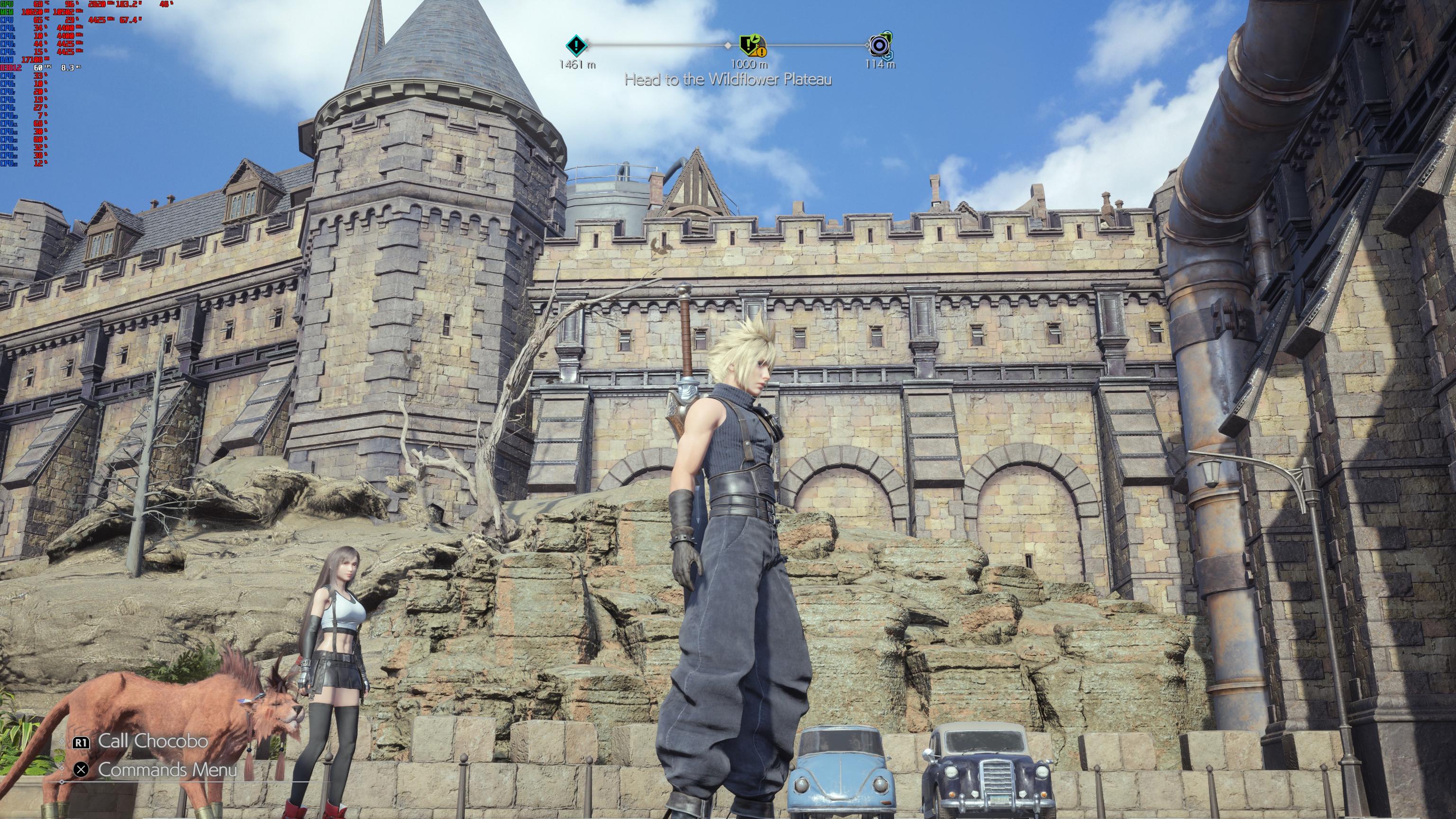

Almost any UE5 game will, and no I don't have much running in the background.
I have MSI Afterburner set up to display CPU/GPU/RAM/VRAM usage on the fly via a toggleable OSD. You seem to be the odd one out here as I know multiple people that run into the same problems at 1440P or above, let alone at 4K.
Here's FF7 Rebirth running at 4K with DLSS, resolution scaling at 66%, mixture of medium-high settings:
That's over 17gb of RAM and close to 11gb of VRAM being used.
I could easily push over 12gb of VRAM with one or two settings changed, and that's an UE4 title.
