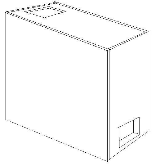

I was thinking something like this.
A hole at the bottom with a fan sucking in air (very low speed) with a fan at the top/back pushing air out. This should keep it somewhat cool, seeing as hot air rises?
The picture is rubbish, but I was thinking a couple inch walls?

Alternatively make a case for your current case, like the image you drew above. You won't have to worry about fittings and spacing as much and it could have a lid/door for access.

haven't got a pc at the moment, in the process of a new one. Got an old one which I could trial out though.
The case I drew could be on a hinge system? Alternatively it could be nailed together? :D

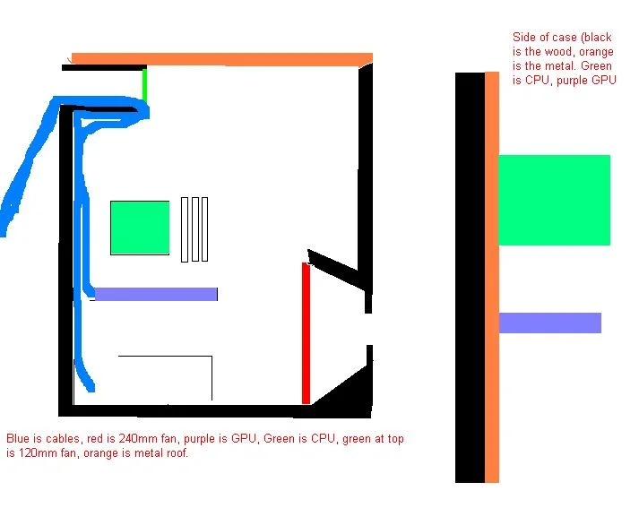

It's going to be a gaming PC.
Having looked at the existing options, I was thinking of sticking with the very thick heavy wooden exterior, have the bottom open up to a very low RPM 240mm fan (the heavy wood construction should ensure no vibration at all).
The top of the case would be constructed out of metal (if possible with a fin construction inside, or at least roughed up to increase surface area). At the top would be a small opening which would be lead a considerable distance inside the case (making use of the size to help noise pollution). A 120mm fan would push air out.
The graphics card + powersupplys would have no access to the outside, the cables being routed up through the case and leading through the opening at the top where the fan is. Both CPU cooler and Graphics card, will have contact with the side of the case which will be encased in metal and will connect up to the top of the case where the 120mm fan will be shifting the air outside.
Except for that case by Zalman the material your case is made of has nothing to do with dissipating heat as they are not connected to the heatsinks/components that produce the heat.
Wood is a very good material for noise deadening versus steel or aluminium.
Agree to disagree, but I like the Zalman case you pointed out.
