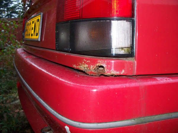

Here is a bit of the damage FYI:
There is the first bit, with more round the back under the inset for the rear reg plate lights (almost impossible to see in that photo due to light and angle). It is not the original bumper as the car had a bump at some point. The rust on the corner of the slam panel above the bumper and below the cluster has been cut back and new plates welded in behind and filled then smoothed. Pics were 6 months ago befire I picked it up. The cluster was drained as well, some people have no care for the vehicles! :p

That a renault 19? :p
Sure is buddy! :D A bloody expensive one. Other than that at the back, and the usual air vent rust its not too bad. I'm so glad that big horrible hole isn't there anymore!
