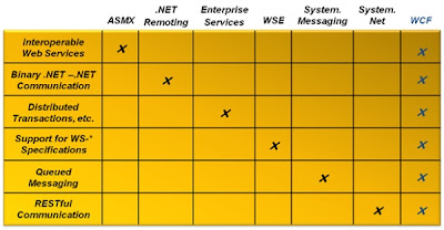

Quick overview of WCF vs other technologies...
People seem to be dwelling on the implementation (it's HTTP therefore it's a web service). WCF is the unification of all the other odds and sods MS has had lying around for ages with various different part-implementations; ASMX, MSMQ, Remoting, COM+ and WSE.

The OP seems to be writing a classic .asmx web service. I simply suggested looking at WCF, which yes you can consume as a classic webservice using the basic HTTP binding (i.e. it looks like a web service to everything). However, it gives you so much more than just basic HTTP (which you are limited to with classic asmx services).
WCF not only gives you BasicHttpBinding, but also the following:
NetTcpBinding
NetNamedPipeBinding
NetMsmqBinding
WSHttpBinding
WSDualHttpBinding
The latter two are "web services", but unlike asmx web services you aren't limited to hosting in IIS (this is also true with the basic HTTP binding). Therefore, I wouldn't say that WCF is the same as a web service. Saying that WCF is just a web service is selling it very short, just like saying WCF is just .NET Remoting.
