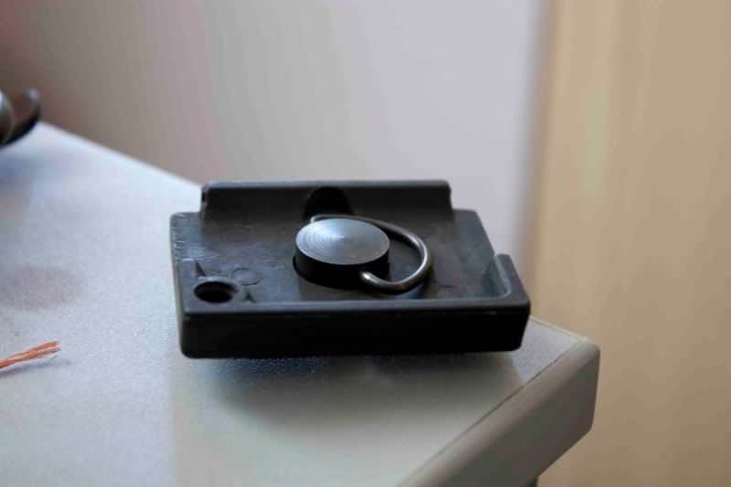

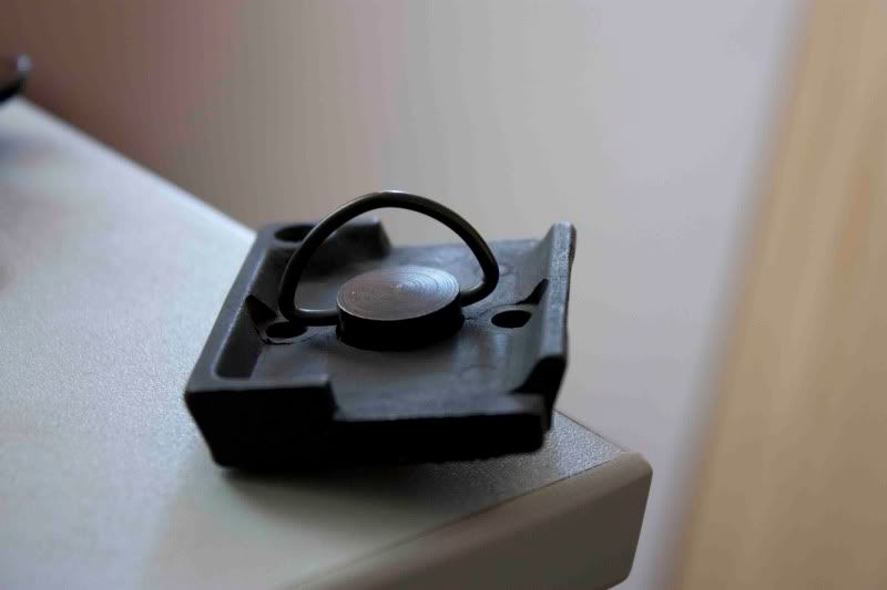

Here it is.
I've been tugging at the ring with my finger and it seems to be ok?

I already have a few spare tripod mount plates and I wondered about the strength of the little d-ring before I even read about it on the website. The d-rings are just made from pressed metal and probably only protrude into the tripod screw by a couple of mm at most. I could probably bend my d-rings just by over-tightening them.
I wouldn't trust hanging my camera and lens from a tripod mount plate d-ring.
