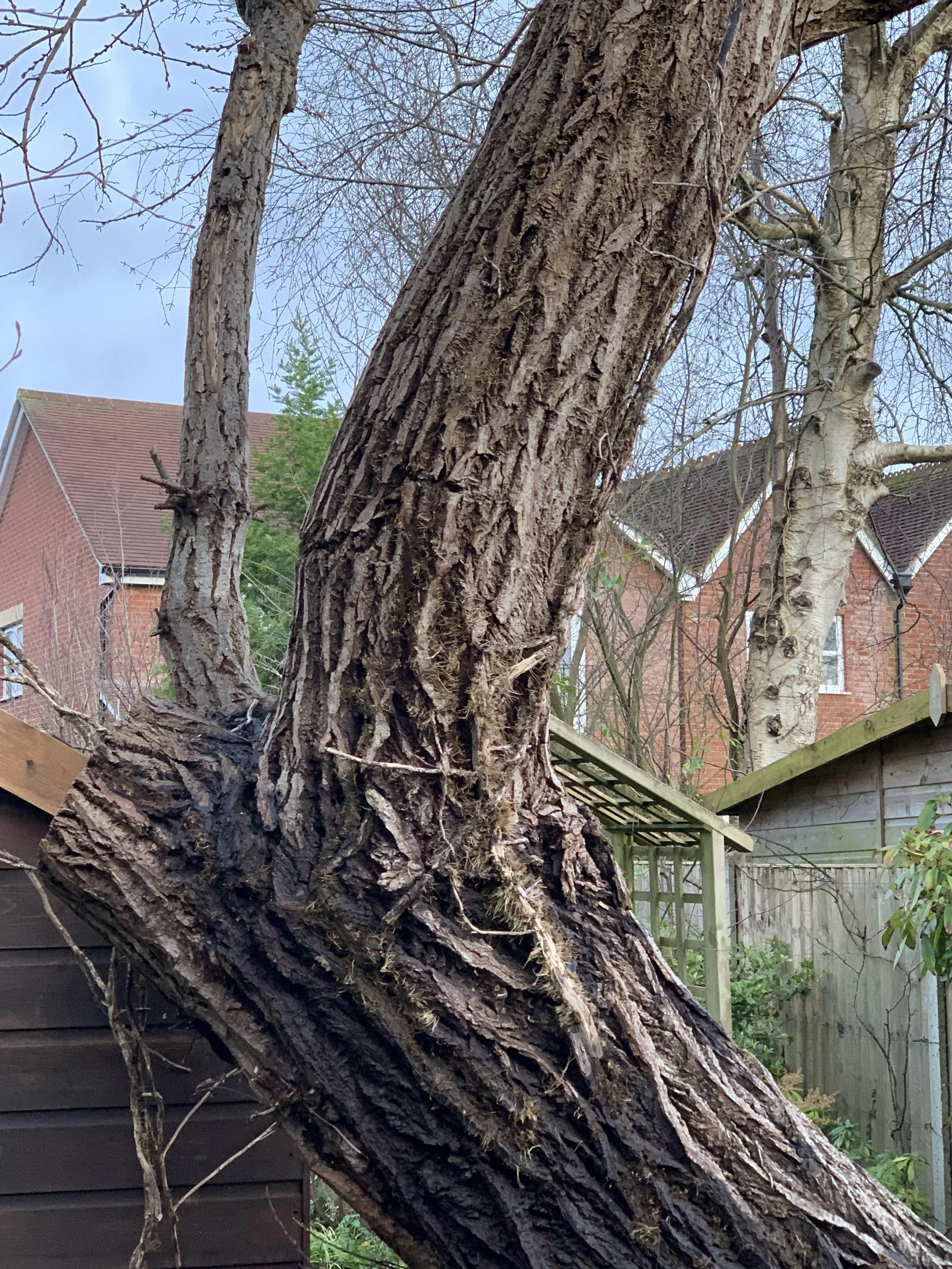

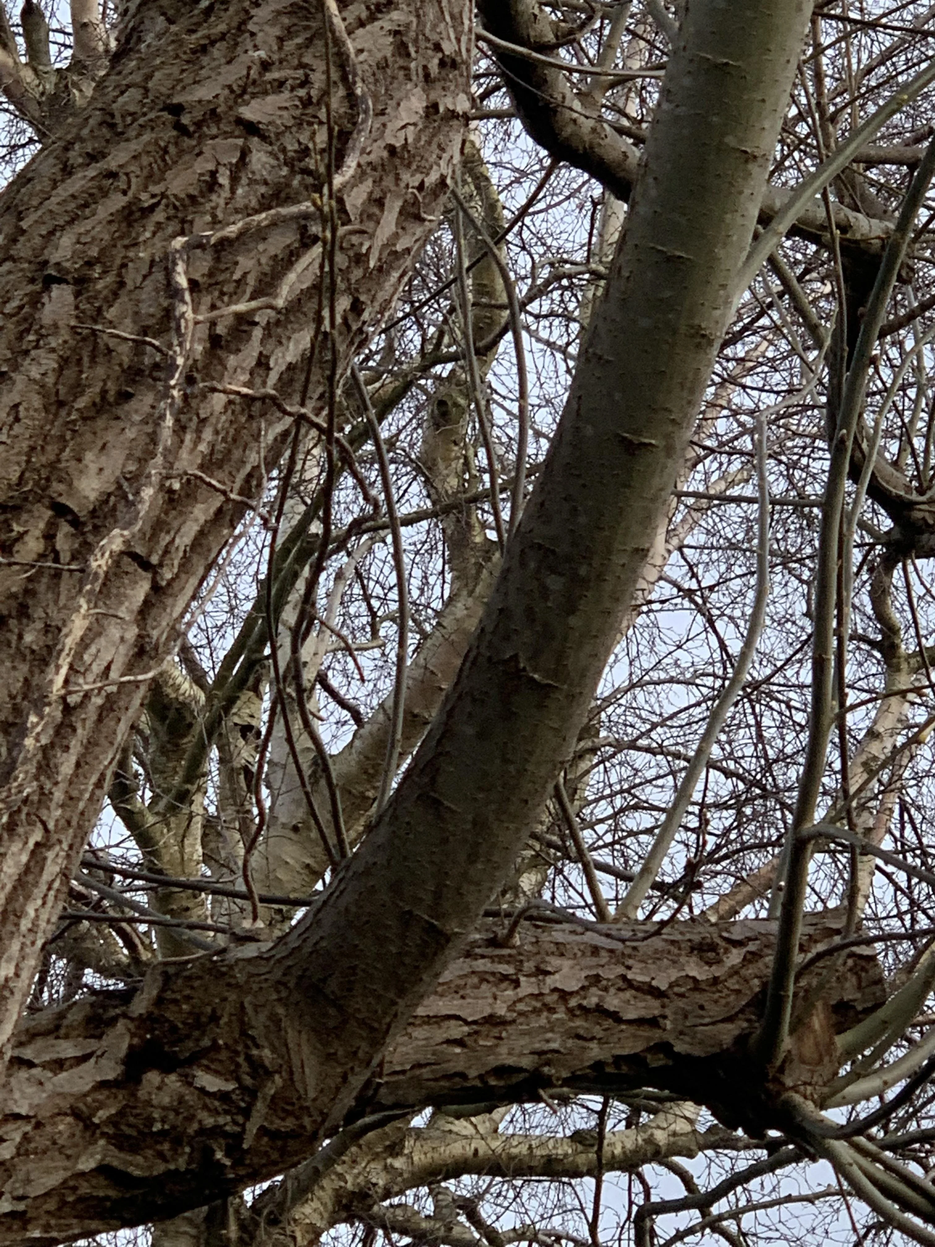

The trunk has been ravaged by ivy at some point:
The younger branches have much smoother bark:

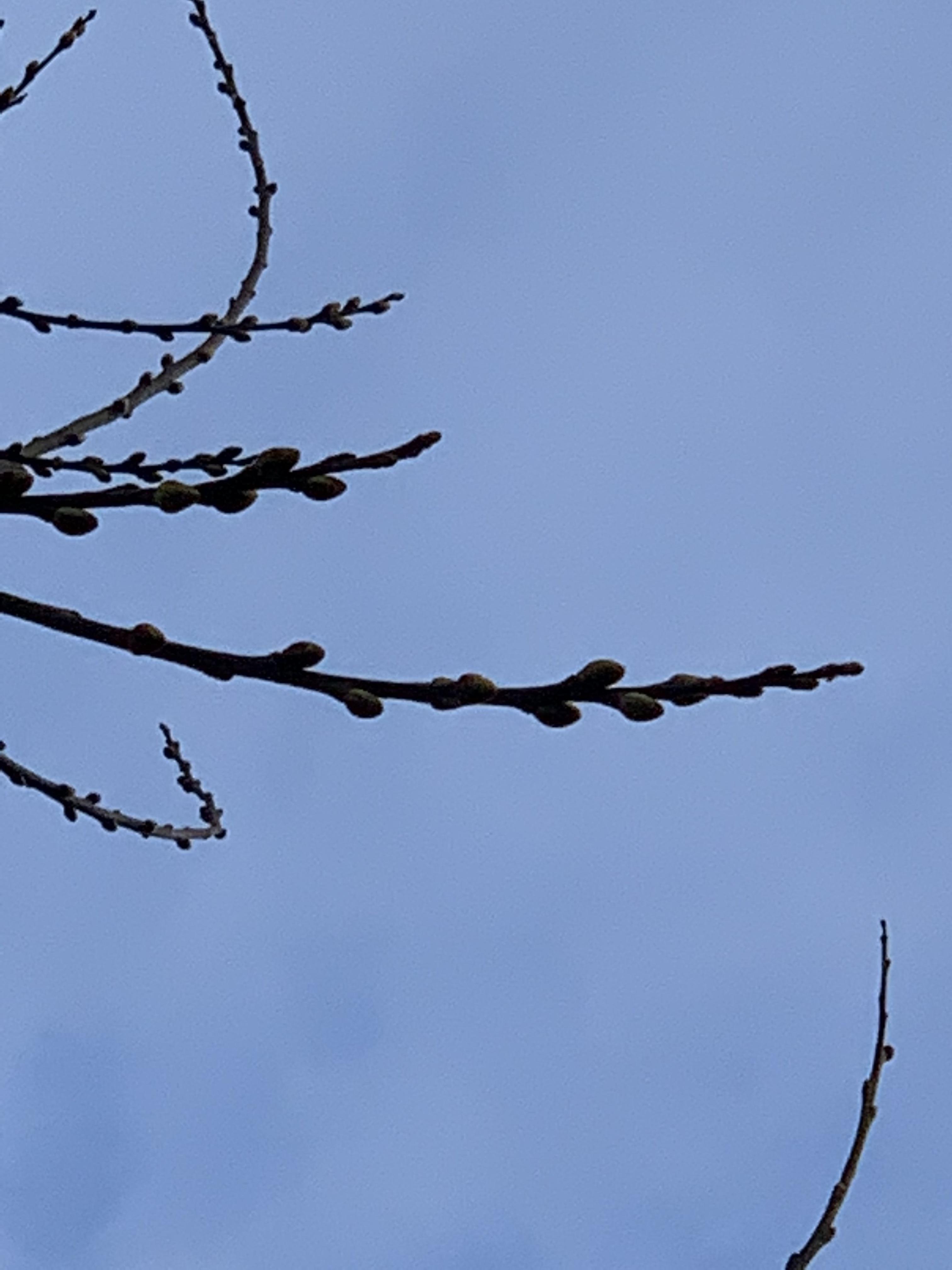

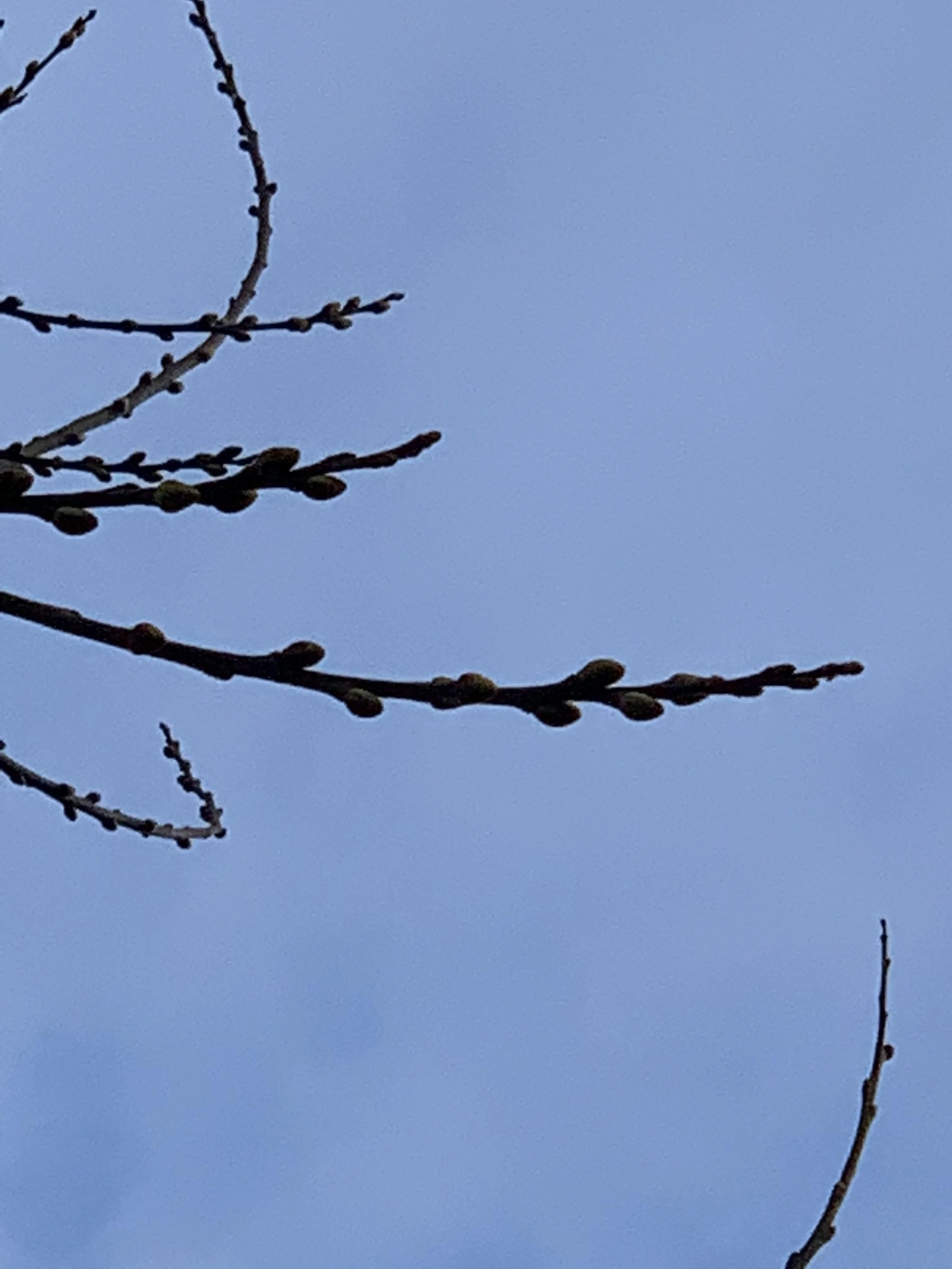

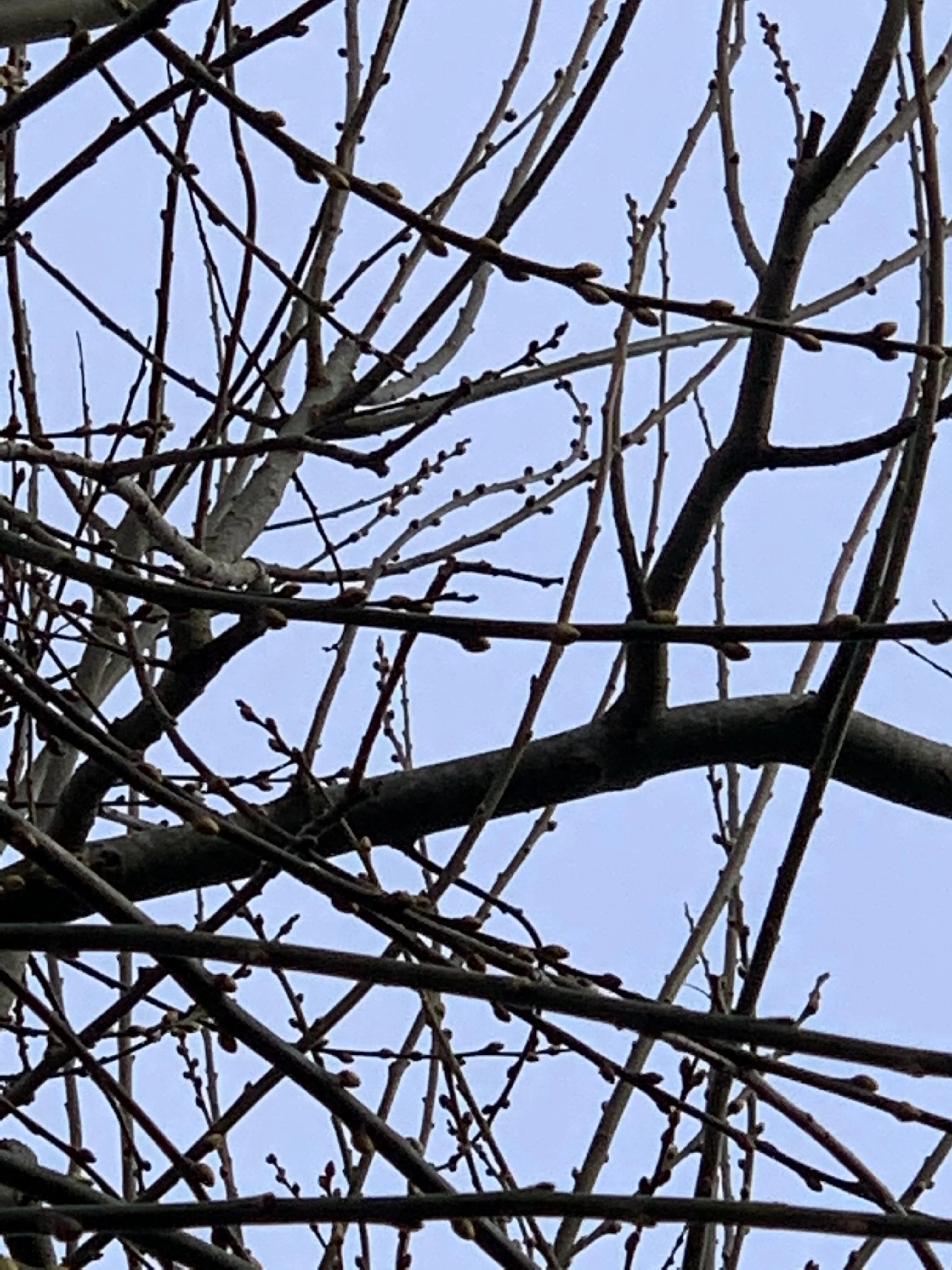

Thought these pics of the buds on the new branches might help, but I can't get close enough to tell if they are sticky or not:

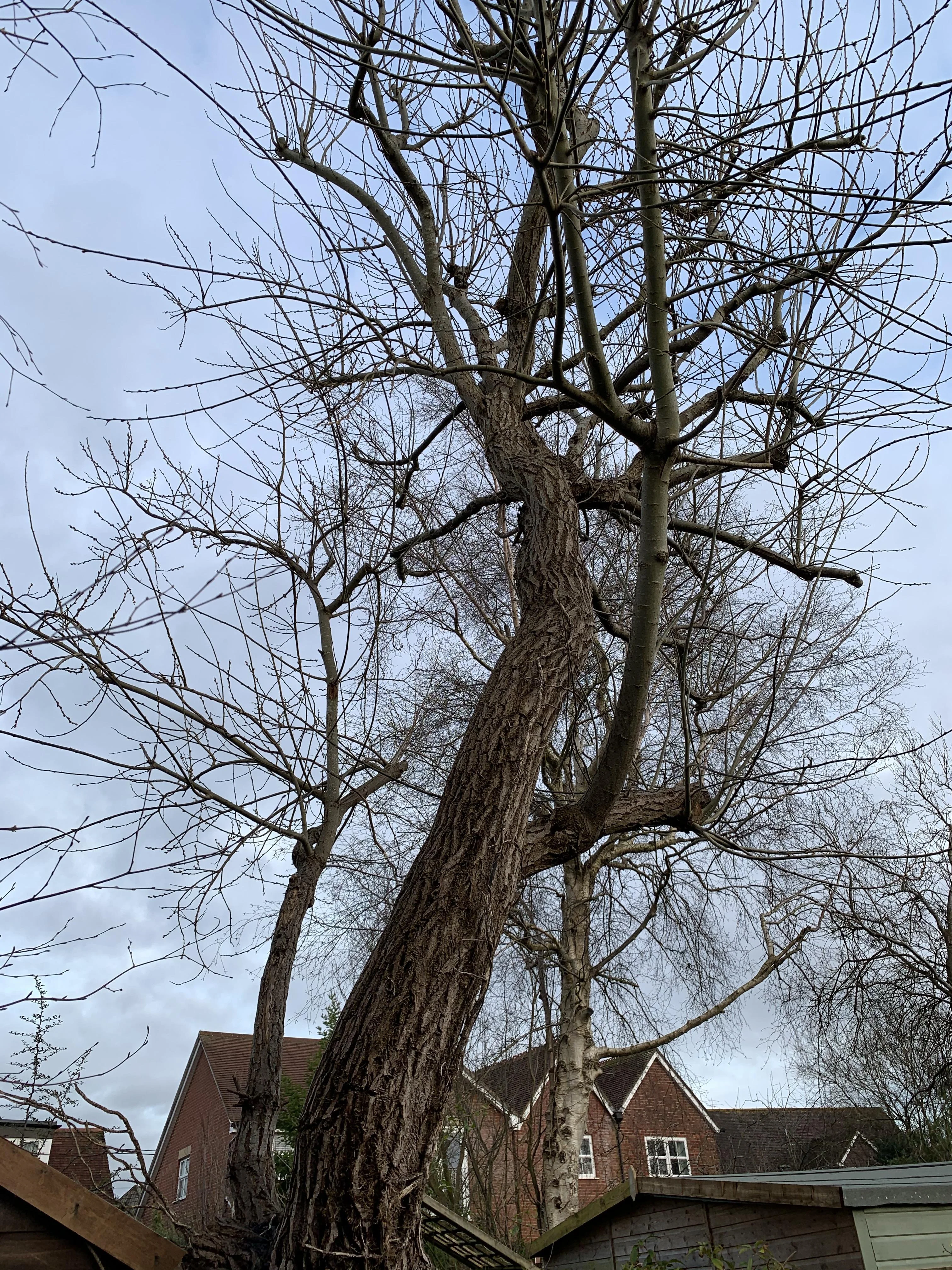

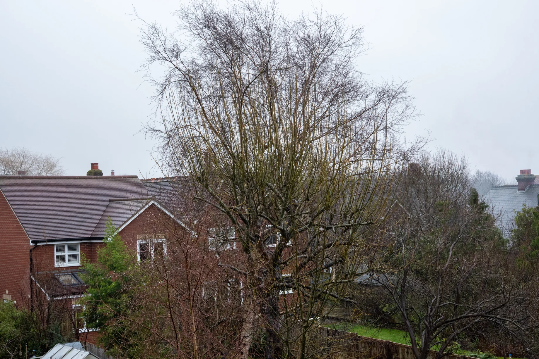

This is the top of the tree. You can see the new branches are very long and thin, and are shooting almost straight up vertically:

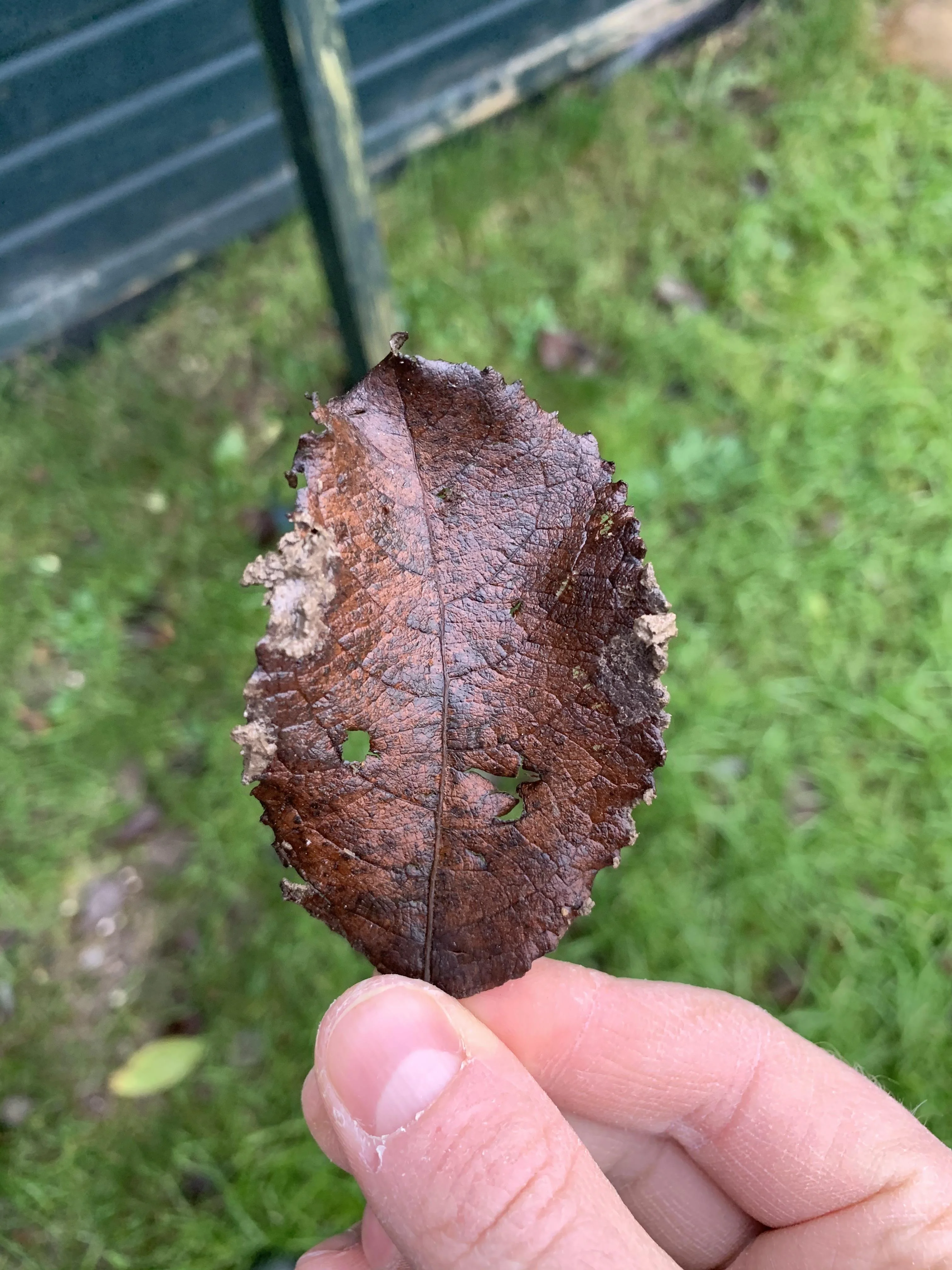

Potential leaf:

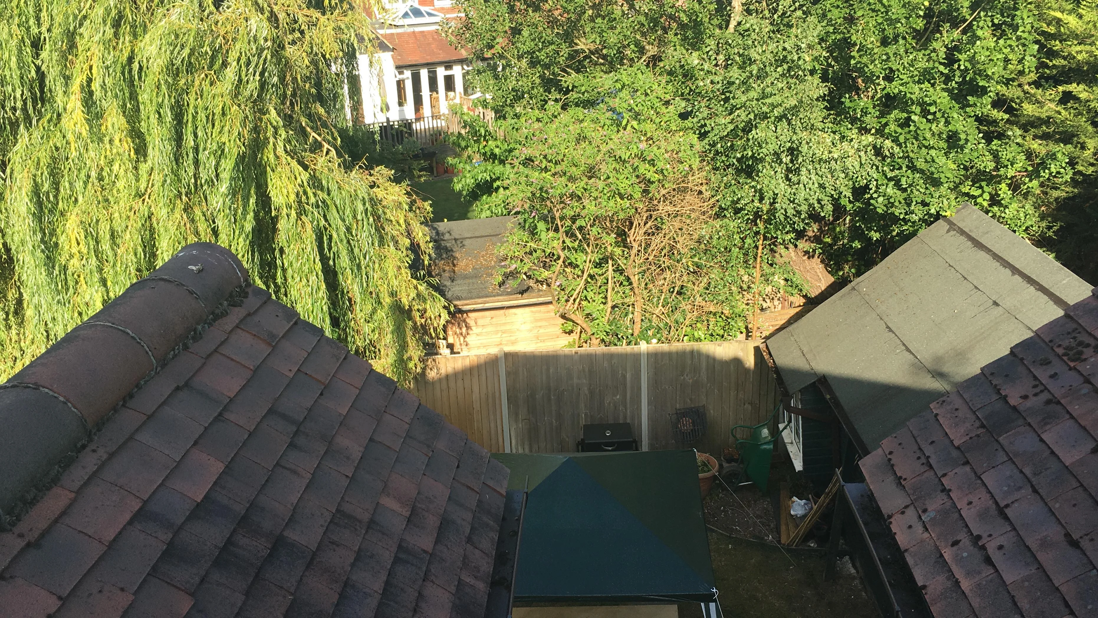

Summer photo — it's the darker leaves in the top-right corner.

Thanks. I think the bark is too rough and too dark to be a beech?

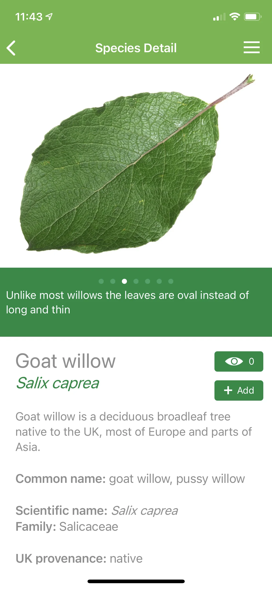

I should have mentioned, I've got that app but I'm not confident enough with any of the suggestions.
Based on the criteria in the app, it could be a Pussy Willow, or it could be an Elm… :o
Thanks, it would make sense as the site used to be a pond and there's a weeping willow about 10m away.

Pussy/Goat willow is my guess.
https://www.treeguideuk.co.uk/willows/
Your example leaf is manky but there's a suggestion of a twist at the tip which alongside being a rather wide leaf for a willow is what the above is known for.
That and the catkins are kinda distictive fluffy and grey.
Thanks again, I'm going with Goat Willow. It's one of the thirstiest types of tree so if we base the spec on that, we should be well covered.

Not a beech and not an elm, might be willow of some kind but its large for a goat willow.

Yeah, maybe not a Goat Willow — my tree surgeon friend said it could be a large Goat Willow or a Grey Willow… or a Poplar!
It doesn't make a huge difference, to be honest. Willows and Poplars are both in the NHBC 'High Water Demand' category so either way, that's what the calculations will be based on.

Oh. I don't think that leaf is from that tree. Because it doesn't look like a willow leaf
It's quite possible that it's from another tree. There's a number of them in that location so it was a bit of a lucky-dip.
However, it did look similar to the reference leaf on the Woodland Trust Tree Identification App:
The bark and twigs look close as well, and my wife insists that it had catkins on it last spring, so together it was a good a guess as any. :)
As I said, if we base the foundation calculations on it being a Willow and it turns out to be a less-thirsty tree, we won't have done any harm.

That does look like a the leaf to be fair. It's quite possible I've never seen a goat willow. All the willows I've come across have been the pussy/crack (seriously these names ) willows. Which I both think have the long leaves
