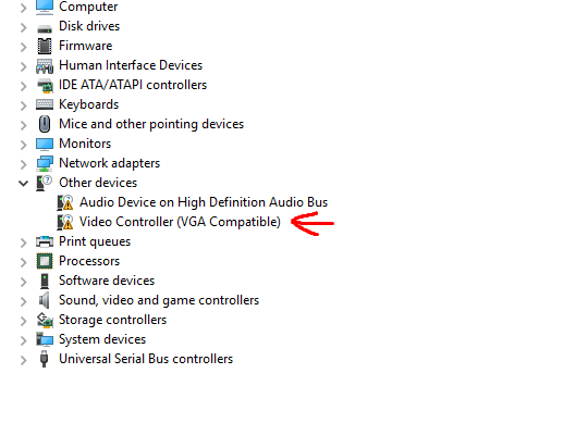

Cant install Nv drivers

so i was having a couple issues crashing on BF V so i thought i would install the new 417.22 drivers so did ddu and when i went to install it failed so looking in device manager it would appear the card is not being detected properly and everything i have tried is not working. have even tried following an old guide on manually adding the device id to nvidia installer still no joy

Why turn to DDU? A simple uninstall/reinstall not suffice?
At this point if you have fubared it, it's time for a windows reinstall.
Well i remembered i did the vBios update that allowed 127 power target over the 115 on the original so flash the original back and it installed fine.
