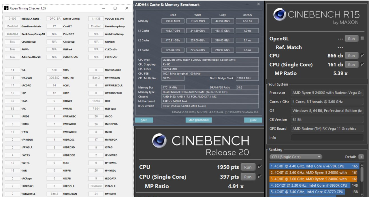

I managed to do 3400CL14 on my 2400G with the same Asrock board which is pretty good going considering a 2400g is a Gen 1 Ryzen CPU rather than Gen 1+ like most 2xxx chips, so there are overclocks to be had, just need to be more realistic.
I also have the same cruicial RAM(I could dump the timings out for a starting point perhaps) but interestingly it seems you have two types of RAM, that will make your life harder than a matched set, what you get with 2 sticks with typically be superior to 4 sticks, with the OPs chip being Gen1+ he could potentially get a touch more than me, though that was not my experience moving from TR1 to TR2, as all down to the memory controller and whether you win the lottery.
You also need to bear in mind that anything you get over 2933 is an overclock for Zen+ and you are winning :)
My 2400g has 3200cl16 ram doing 3400cl14, my tr2920 has 3600cl16 RAM doing 3333cl14, no matter what latency I ran it would not go above 3400cl16 on the TR, so settled on slower clk but tighter timings, that's life :( Still quick :)
it is not so much about what the memory is capable of as these speeds are defined primarily for Intel chips, it is about what your AMDs memory controller chip can do. Zen2/Gen2 chips with 7nm have better memory controllers and may get you nearer Intel level speeds but I think most are topping out near the IF max speed between 3600-3800.
numbers from my little machine
Added timings above :)
Could probably spend more timing on it but it spends its time doing homework and playing minecraft, doesn't really need it :D
