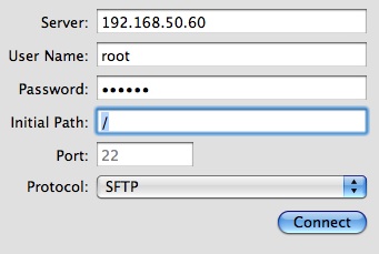

ah cheers, that works. I'd still like to use a browser though as I don't know any commands, but Transmit just gave me the same error message as before

Are you choosing SFTP as the protocol like this:
