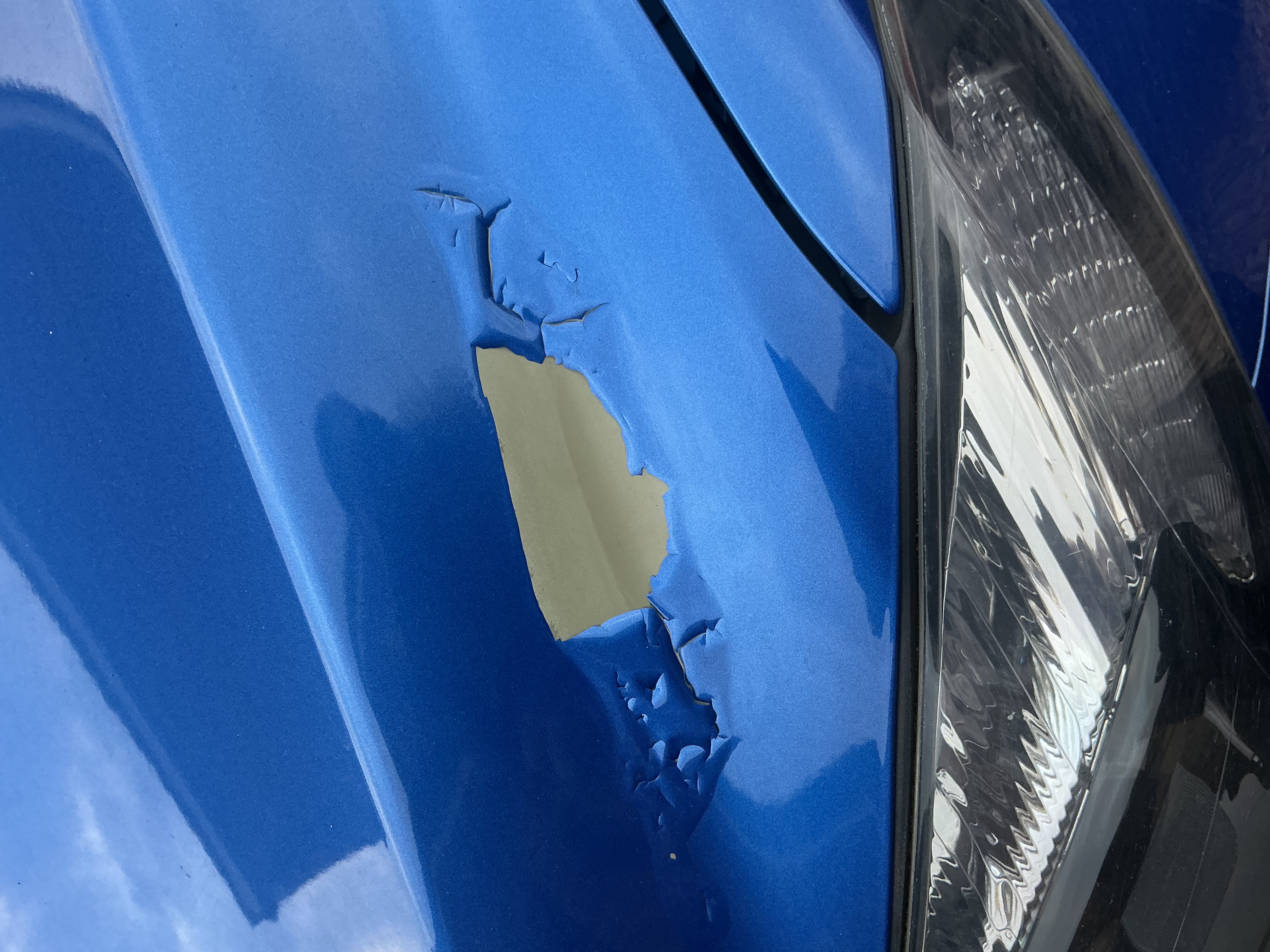

Does this look like an old damaged repair that’s blistered? Vandalised? I’ve never seen paint do this before so no idea what’s happened. It’s on the wife’s 16 plate Mokka.
Hmmm....a quick google reveals
This is a known manufacturing issue specifically affecting 2012–2016 Vauxhall Mokkas in blue, often referred to as Boracay Blue.
BBC +1
The peeling you're seeing is due to a failure in the primer layer applied during production. Because the paint does not adhere properly to this primer, it eventually lifts and flakes off in large sheets, frequently starting as a bubble or blister. Common "hotspots" for this include the bonnet, boot, and windscreen pillars.
Is there any help available?
While your car is likely outside its standard 3-year paint warranty, the widespread nature of this defect has recently gained media attention from programs like BBC's Watchdog.
BBC +2
  • Goodwill Contribution: In early 2026, Vauxhall stated they would review claims for a goodwill contribution of up to £1,000 for paint repairs on Boracay Blue Mokkas from this era.
  • Eligibility: To be considered, you generally need to provide detailed invoices from a professional body shop registered with Companies House and proof of payment.
  • The Catch: Vauxhall often denies these claims for cars over 6 years old, citing age rather than a defect. However, many owners have had success by escalating their complaints through formal letters or social media.
Recommended Action
  1. Do not use a high-pressure washer on the affected area, as this will likely strip more paint away.
  2. Contact Vauxhall Customer Care at 0800 026 0034 to log a formal complaint.
  3. Gather Evidence: Take clear photos of all affected panels and check for bubbling in other areas, as the issue often spreads.
  4. Specialist Assessment: Consider getting a quote from a reputable body shop. Some owners have found that simply repainting the patch isn't enough because the underlying primer is the problem—the whole panel (or car) may eventually need a full strip and respray.
Update - Called Vauxhall on that number above and they recognised straight away the claim and sent me an email with instructions on how to claim. My nearest main dealer is in Nottingham so gave them a call and they have had a few Mokka's already in for quotes, didn't say if they actually carried out the work mind so will see if it comes in under the £1000 Vauxhall will pay.
Anyone have an educated guess how much a main dealer should charge to strip back a car bonnet to bare metal and do a total respray?
Hard to say as it heavily depends on location... I'd say probably more than a grand for a main dealer. Do they actually have a body shop in house? They are likely outsourcing it. Go direct instead if you can.
Bare metal is more costly as you need to key the surface back to bare metal and use etch primer. It's a lot more effort to go back to bare metal than regular keying and repainting.
