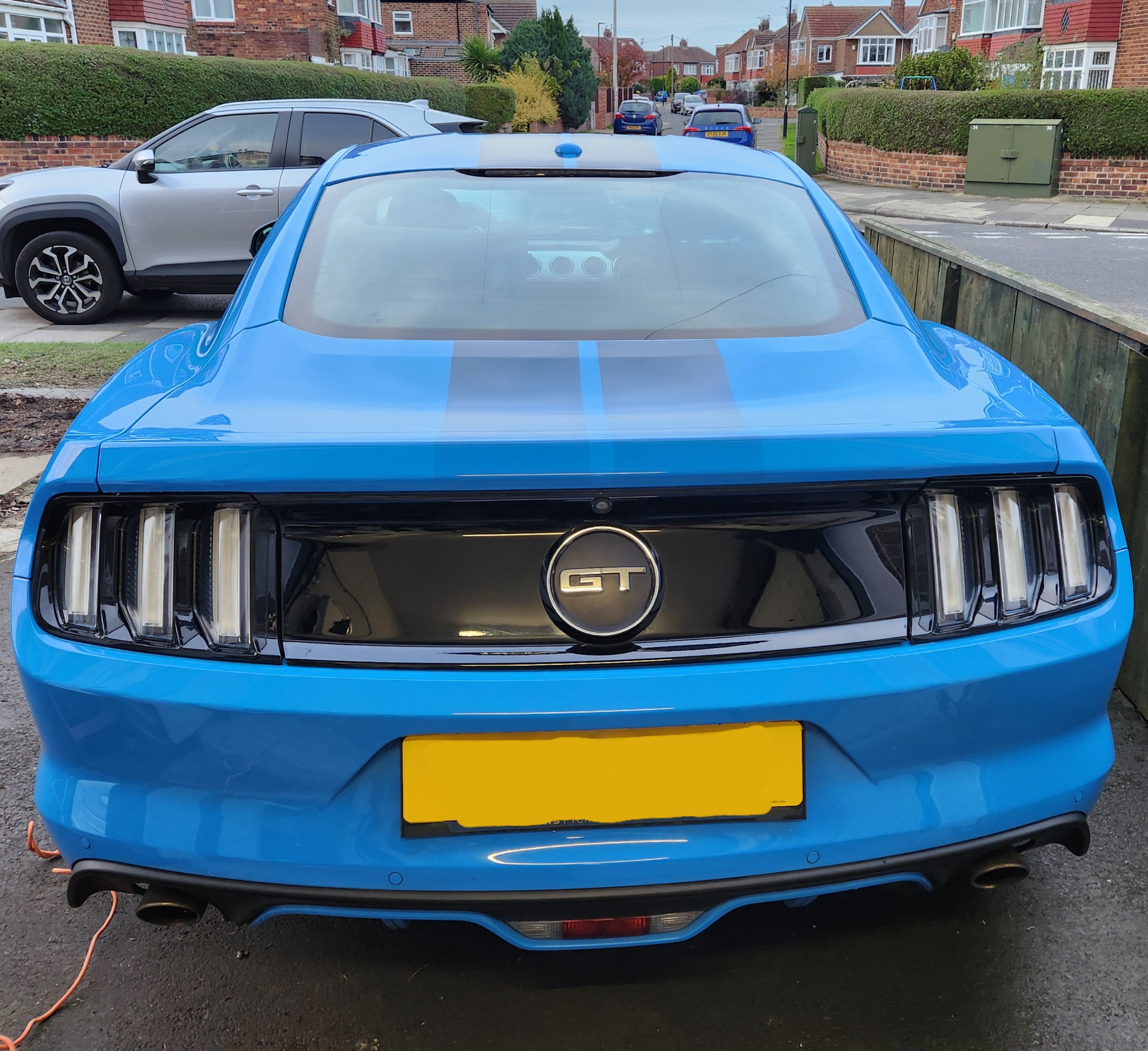

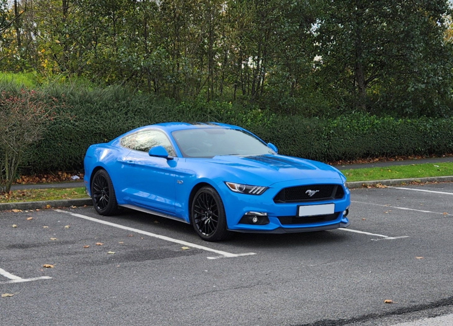

Thanks for all the advice guys, this thread has too much complaining from myself, so heres some Mustang pics
Also if anyone was wondering how I did not see the tyre change, collection was a bit of a nightmare as it was one of those monsoon days and I was trying to concentrate on other stuff that had been done (stone chips, alloy scuff etc) overcast and hard to see, I just noticed the tyres were new.
