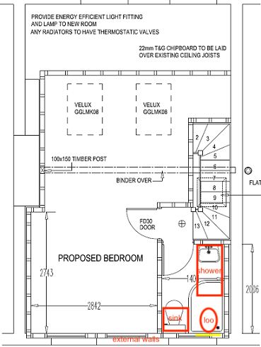

This is the layout, the staircase has two turns. (taken from my other thread, ignore the red)
Fwiw our living room which is about 25 sqm was about 600 which was carpet/underlay and fitting. Think the carpet was 15/sqm or so. We had the stairs/landing done and I think fitting was about 75 quid, but it took most of the morning. I hadn't realised how easy a square room is compared to stairs (and our landing is shaped like a Π, so took a while too.
