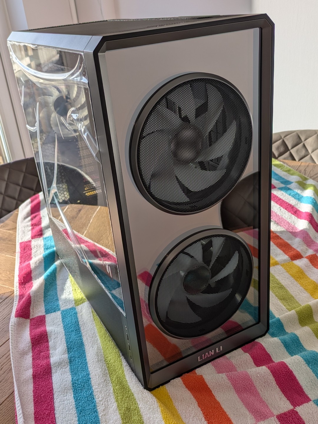

It's been over 5 years since I last changed my case (Enthoo Pro M). I liked the front of this case with the large fans so thought I'd give it a shot.

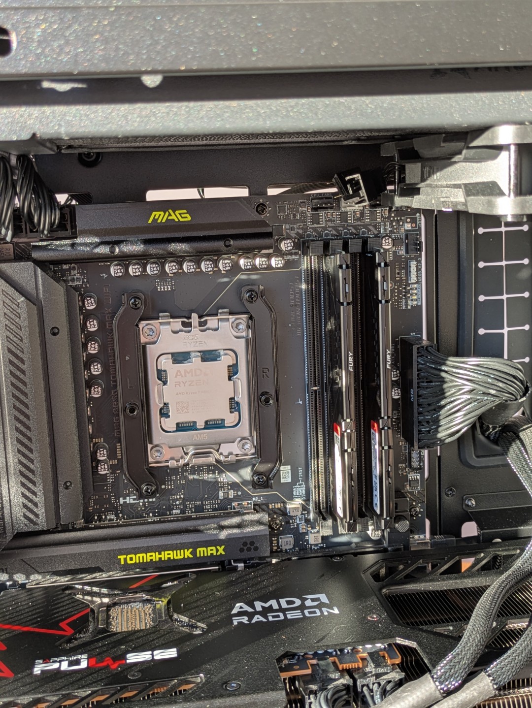

Building was a doddle with plenty of room. I like the clip on sides and that you can remove the top to install an AIO. Here's a couple of pics from the build:

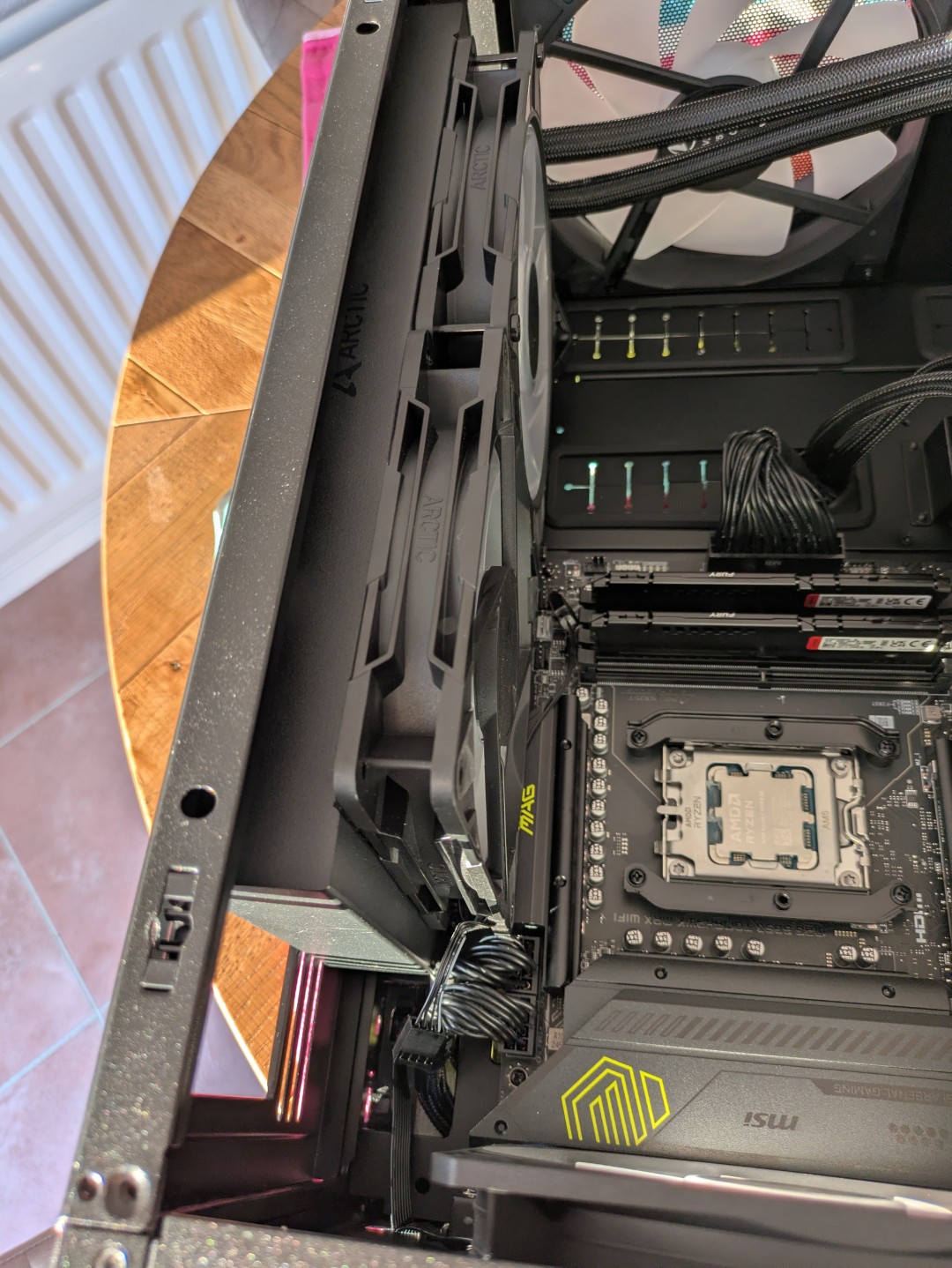

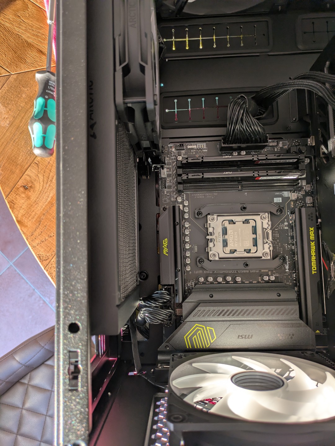

The next 4 pics just show that my Arctic Liquid Freezer 3 280 doesn't fit, I didn't pay due diligence!! The case allows AIO up to 60mm but mine is 67mm so the 2nd fan won't fit on. However, working fine with one fan installed until I source a replacement.

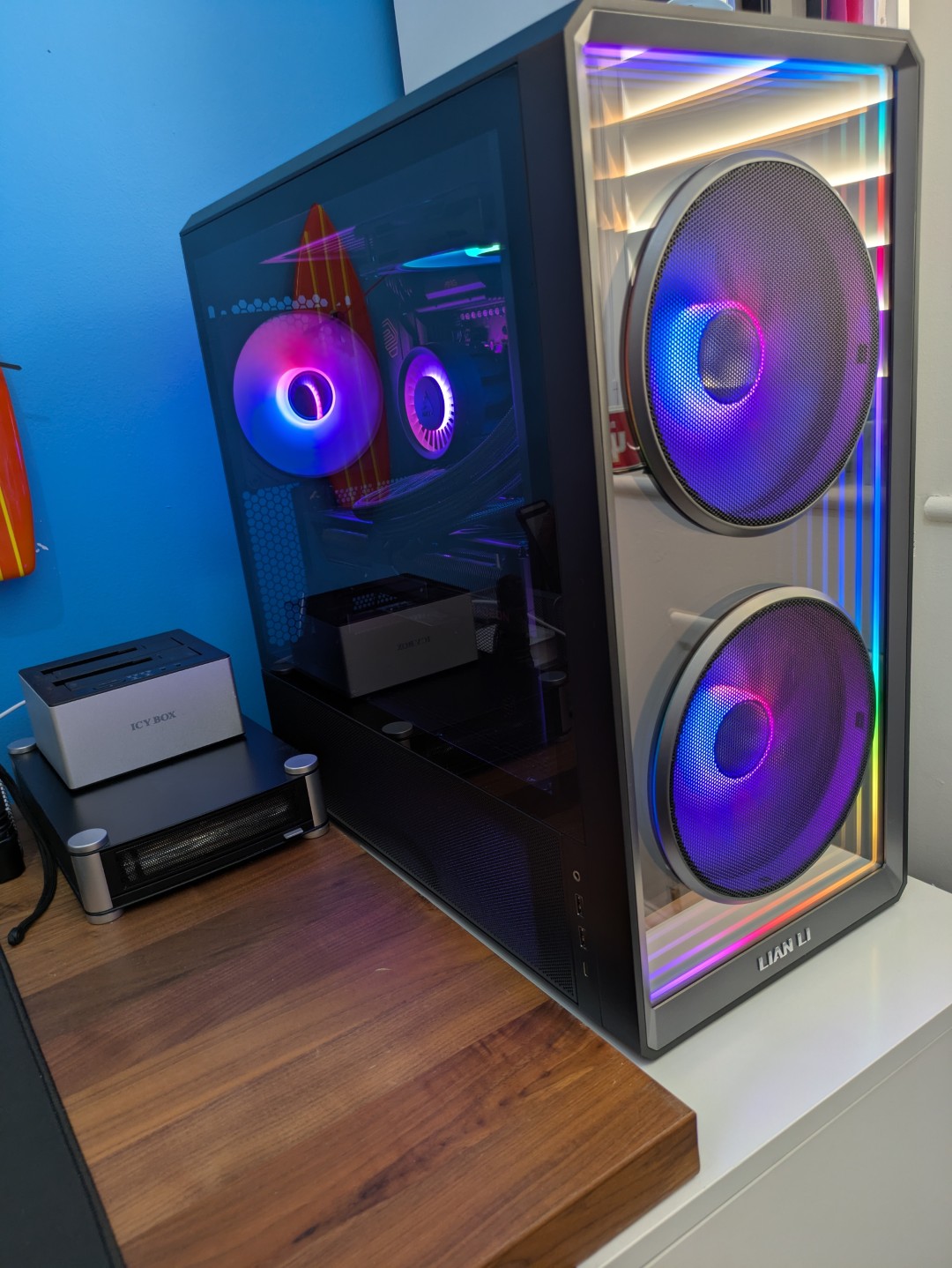

Lastly, this is just a pic of it switched on. I'm not usually a big fan of RGB but I quite like this.
Cable management was very good and I like the fact you can install the PSU sideways if it's small enough.
Are you going to get a thinner 280mm AIO or a Arctic 360mm that should fit (85mm max thickness)?
Can't tell from the pictures but can the radiator be moved away from the motherboard or is it to close to the side panel of the case already?

I ended up buying a Corsair Nautilus 360 ARGB when it was on offer, fits perfectly and looks nice.

Arctic Liquid Freezer AIO are useless in this case then because they are too thick?
If so that is poor design by Lian Li it's not like this is a matx type case.
Can anyone confirm this pls?
I take it 360 is only one which fits fine?

Hopefully you'll be fine :) I ended up buying the HAVN BF 360 and it's been fantastic, a joy to build in and keeps everything cool and quiet.
Build finished. Perfect timing with my little niece and nephew over so they could play with the light switches on the case :p.
Fans were at 100% but figured out it was because I hadn't plugged the 4 pin into the mobo and praise Gemini, as it warned me not to plug the ARGB one into my mobo as they were all 12V.
Build much cleaner now, should be a lot better for air flow and it looks way better. Tempted to get another 3 Lian Li Infinity fans for the top.
Only thing that might need sorting is the Noctua U12A Chromax - temps seem a bit all over the place and the internet is showing different directions for the fan (I currently have the fan nearest the RAM showing the sticker so should be blowing < towards the I/O and the rear fan showing the blank side so also should be going < towards the I/O).
