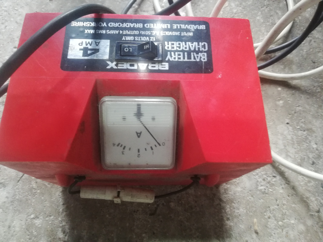

Aye, and the charger I use it at least 30 years old and works fine, probably older, I'll take a picture later if I get a chance.
Edit: there, there is no date on that if anyone can guess how old, I have no idea but I'm guessing at least 30 years old.

I use my very old (as pictured) charger on an AGM battery direct to terminals works fine.
4 amp charger which likely struggles towards the end of the charge probably isn't the end of the world but some older higher amperage chargers will definitely affect the health of some AGM type batteries.
