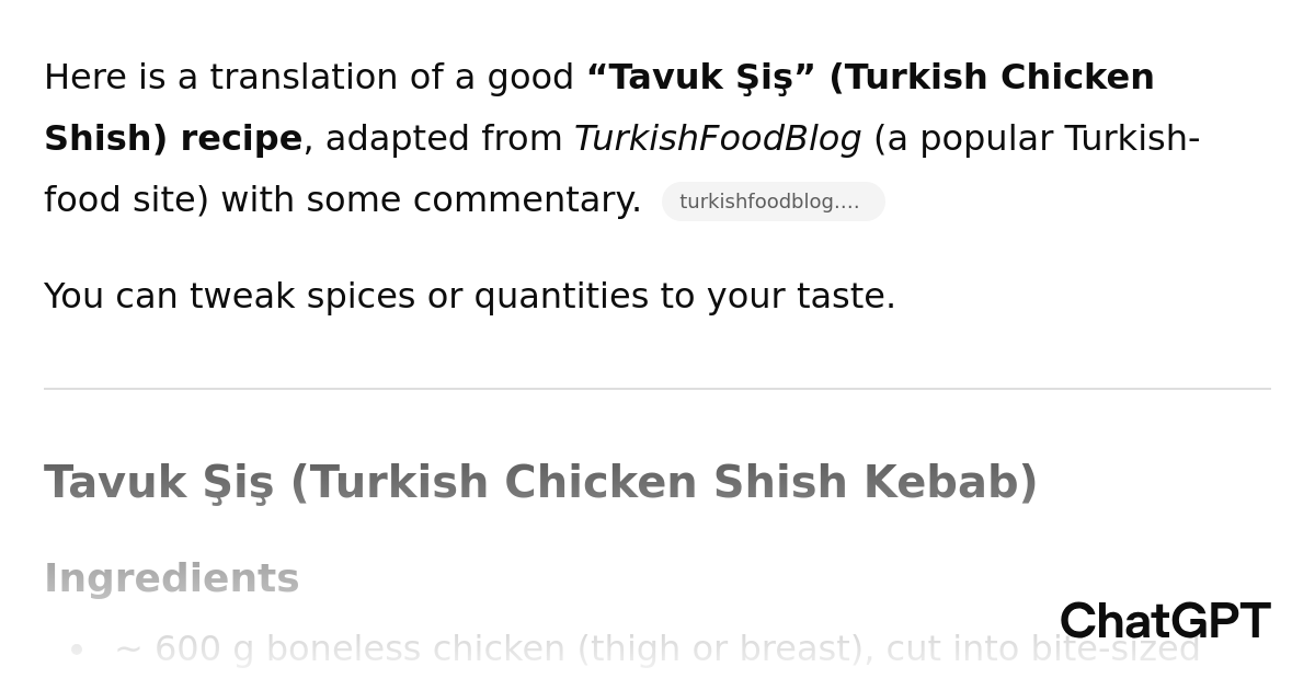

The amount of times I've used ChatGPT for my bike project is nothing short of alarming. And of the dozens of times I've used it, it's been wrong once. Even then I told it that it was wrong and it had a rethink and spat out the correct answer.
Something else I also clicked, is that you can use it to find answers in foreign languages which is very helpful. I was after a proper Turkish chicken shish recipe, so I asked it to find me one on a proper Turkish website and ten seconds later I had one.
I absolutely love ChatGPT.
