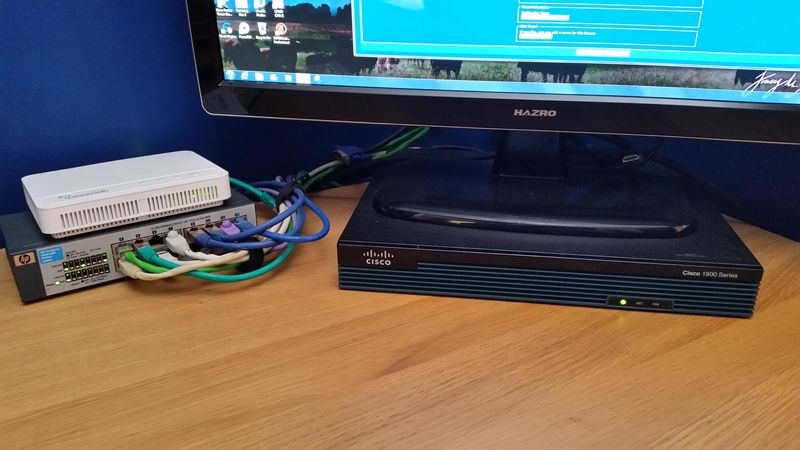

my setup is HG612>1921>HP 1410-16G switch
How do you find the noise with it so close? Is it just like a normal hum from a PC?
i should really move it into the garage or somewhere lke that, just not got the time at the moment. Ive dug out an 887VA and its virtually silent compared to the 1921 (fan is running medium speed currently)
I will swap over later as kids currently both online now.
I've also got a 1921 running my infinity 2 connection using the OR supplied ECI modem. (ECI>1921>HP1910G8>DAP-2695)
Ironic that I've been looking at the VDSL EHWIC card just this week. (in case the ECI modem packs in) Noise wise mine is moderate. If the fan speed remains on low it is very quiet but once it rises it is quite noticeable. (nowhere near catalyst 25xx/35xx loud but certainly enough)
