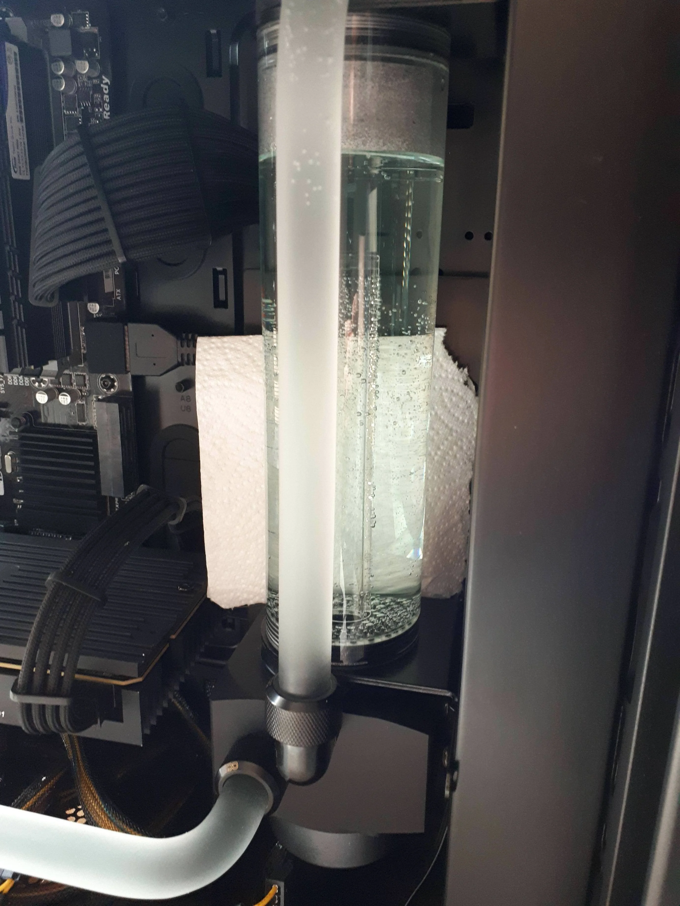

So I finished leak testing my loop with distilled water, and today put in my coolant. It's Alphacool CKC clear, which I had two 1L bottles of. My loop holds ~1.1 litres and I wasn't able to get all the liquid out anyway when draining, so I figured I would leave a little of the distilled water in as it couldn't hurt to dilute the CKC with a little distilled water right? I think I was wrong! After a couple of hours I noticed my reservoir has a bluish tinge, so this happened pretty fast. I've seen speculation that it's the anti-corrosives in the coolant reacting to water that has become acidic. Apparently distilled water can do this?
The distilled water was in the loop for a week, and the loop was left mostly empty for a week, before filling this weekend. I only really have free time to work on this at weekends.
Prior to this all the parts were new - Alphacool copper rads, Alphacool VPP755 pump, Alphacool blocks. The radiators were flushed with hot water, then diluted vinegar solution, then a few rounds of distilled water (circulated first and then replaced with fresh).
What do you lot think? I'll likely leave it as it doesn't look bad and should just be a side effect of the anti-corrosive, but it'd be good to know what's up.

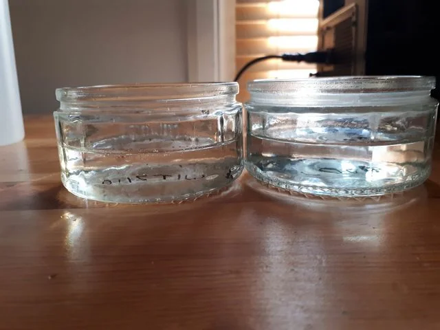

Why don't you test coolant + distilled water in a clean glass to see if the same colouration occurs then if it doesn't happen you can at least rule out coolant, or if it does then problem solved
Ok wow, within seconds one set of water had gone bluey and the other hadn't. The one with water from my loop went blue, the plain distilled didn't. Mad.
