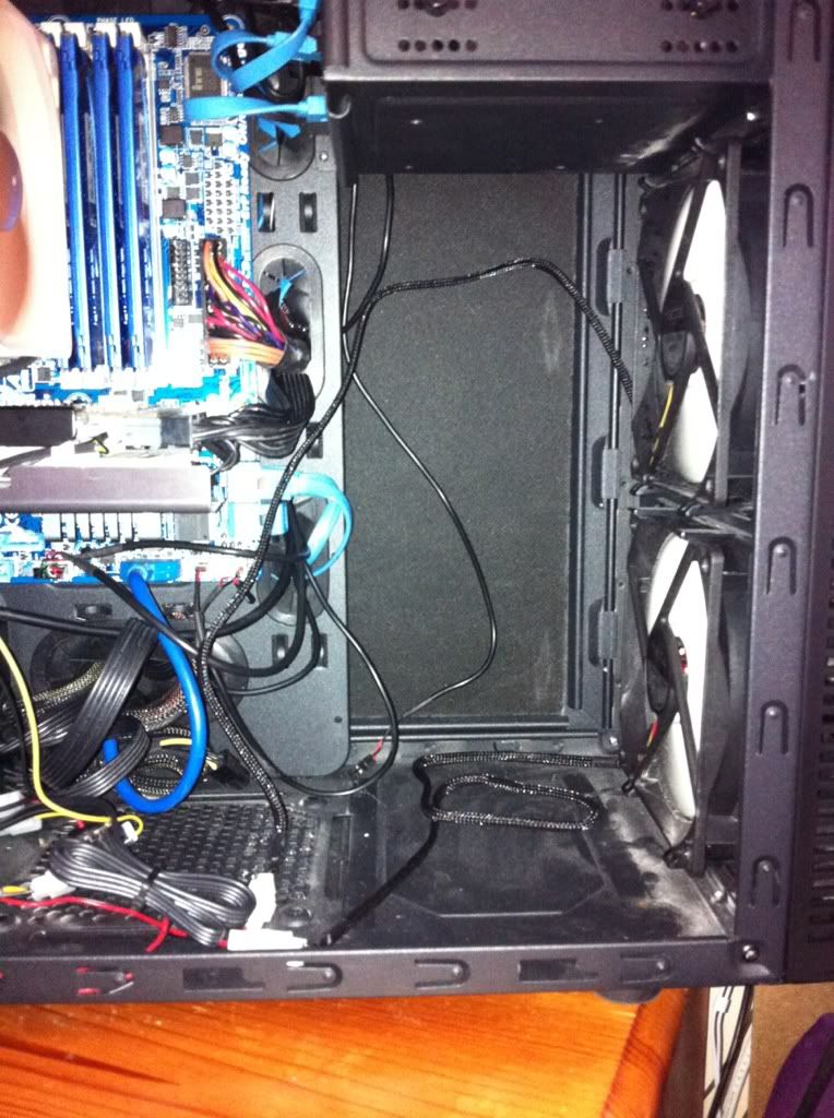

This is the space i have for a rad :eek:
Will be cooling a 2600k @4.5ghz, will be @100% for days/weeks at a time due to folding.
280x190mm, the depth is not an issue as you can see :p
What rad would you stick in there?

Looks like you can fit a full size rad with push/pull fans in there :)
I would suggest the top of the range EK rad, and as for the pump what you suggested sounds quite good. For tubing, I'd get 7/16" tubing and 1/2" barbs, means the hose is nice and tight with a much lower chance for leaks :)
Ive found a couple a 240 rads @54mm depth that will just fit height wise.
I managed to clear that space by drilling out a few rivets and removing the lower hdd cage as i wasnt using it. Im also a good metal worker so making brackets etc is kiddies play :D

I somehow doubt a rad will fit there.
rads have bulkheads at the top which will mean that it cannot mount there.
I could be wrong...
op says he has room for :
so , XSPC EX240 120mm Radiator - Black should fit...just about....
Dimensions: 121 x 35.5 x 275mm (WxDxH)
Correct, the max height is 282mm measured with a tape. width is approx 204mm
Quite a few rads are between 275 and 280 tall... thats hoping the specs are 100% bang on. I hope :D
