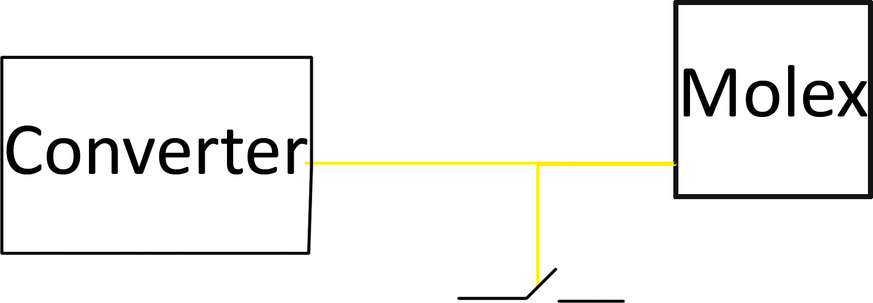

I have another switch, but I know NOTHING about eletronics. Someone draw me up a quick guide?
Heres a small diagram of just the power.
