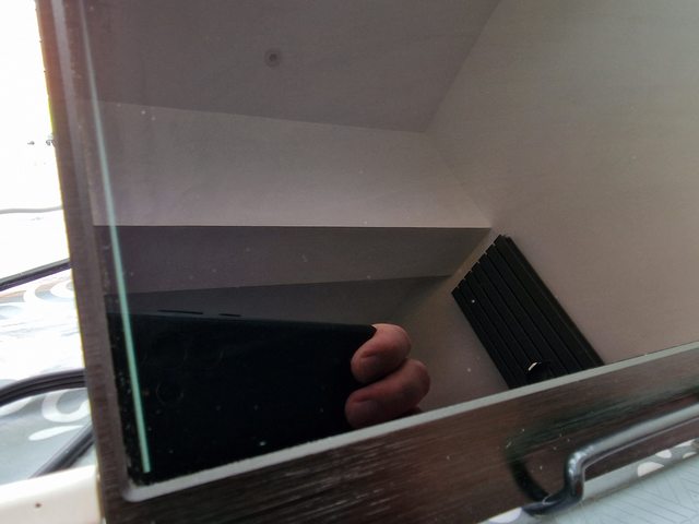

To start fault finding, the first thing was to just switch it on!
Initial power on via the Retroscaler 2x (S-Video to HDMI at the moment):
That is a black screen with a vertical white line, pretty much as expected.
